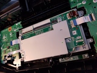

    So as you can see if you were to lift it off you could damage the ribbon. take a small circuit board hook and flip up the black locking clip on top of the ribbon to remove it and then you can put that part of the radio to the side.20180508_145436.jpg
    Now your left with this.20180508_145458.jpg As you can see, you'll have to disconnect the ribbons the same way you did for the two big ones. I disconnected the red and white ribbon on the right side before I unscrewed the metal face plate.

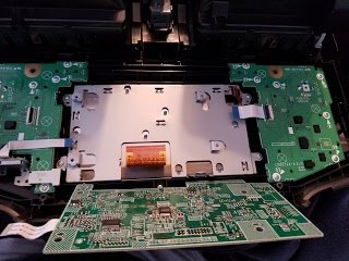

    20180508_145729.jpg Then I unscrewed the faceplate, disconnected the other ribbons and was ready to rotate the circuit board 90 degrees toward myself. There is a soldered ground wire connected to the circuit board which is why you can't completely remove it.
    20180508_150113.jpg Now you cab get to the screen. Make sure all the ribbons have been removed, and unscrew the four screws holding the screen in. It should lift straight out. You will need to remove the screen from its basket and put the new screen in it's place.

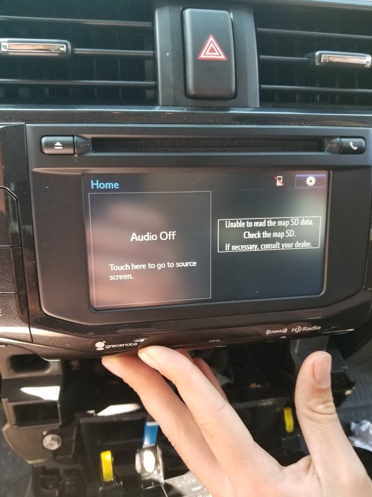

    20180508_154306.jpg As always, before you secure everything back in, give a quick check to see everything is working right. I had taken my SD card out while my screen was broken not knowing that is where they store the map data. I had to go find it and put it back in.
