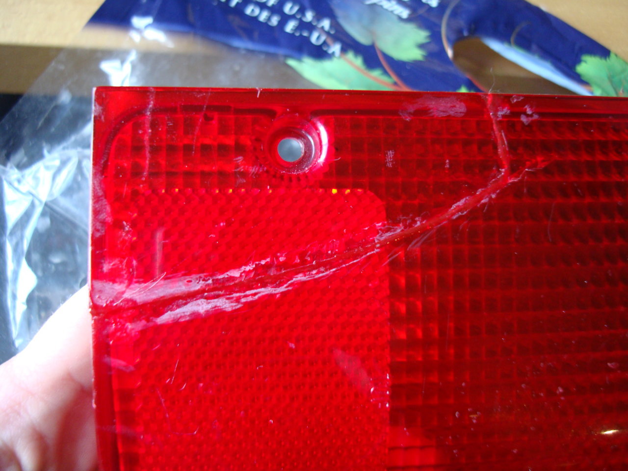

    before polishing:
    white residue is from a previous failed crazy glue attempt at gluing it back. It was too weak of a glue for this type of repair... and/or plastic I guess?

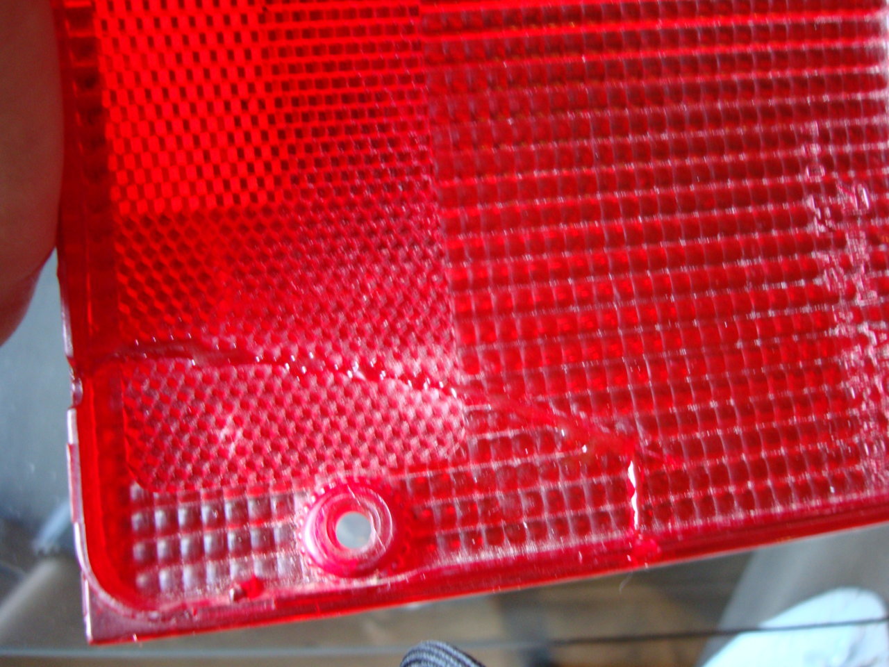

    inner side of lens:
    had to leave a little epoxy joint here, over the crack, to give some strenght to the repair

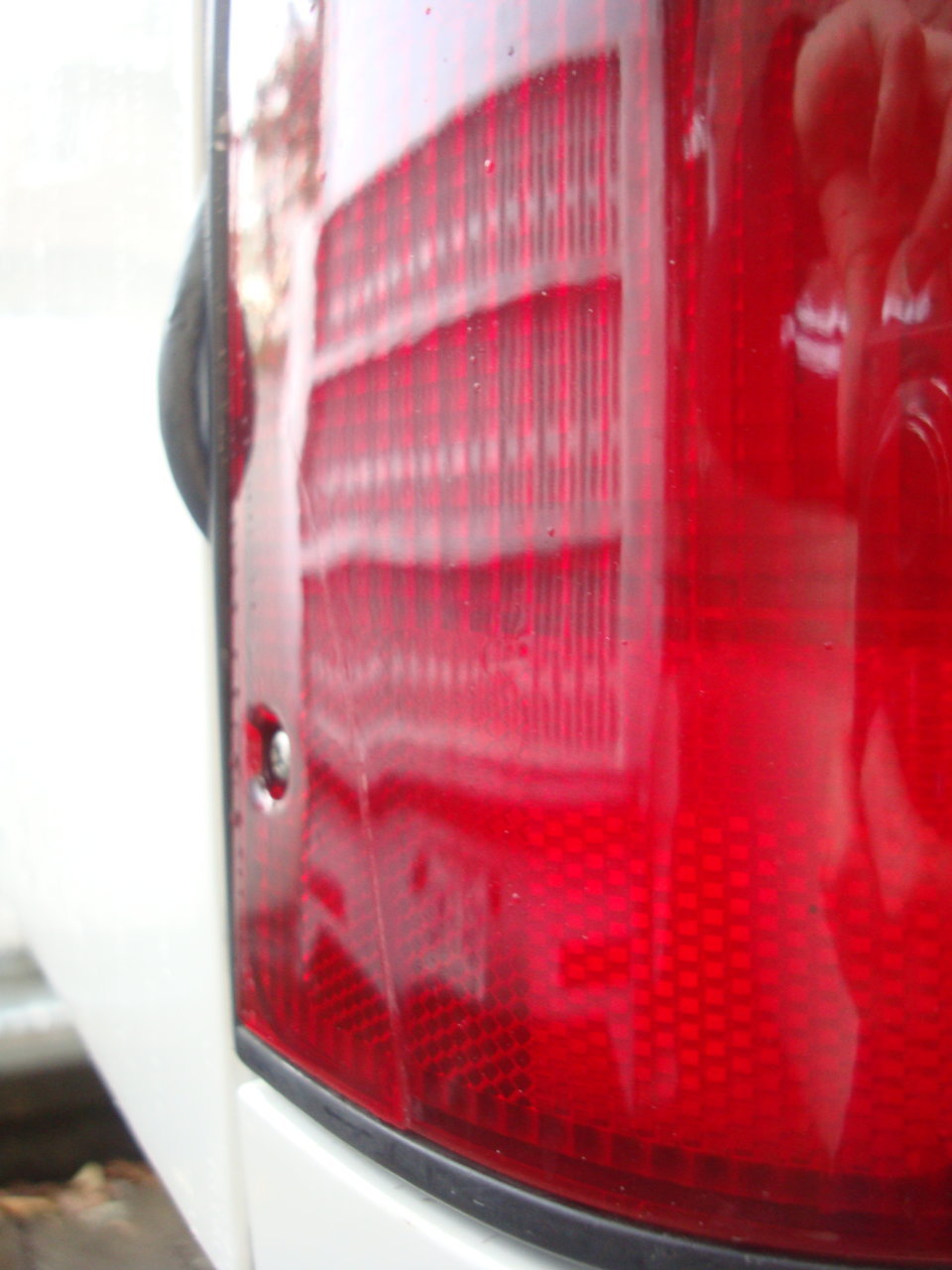

    after polishing:
    as I said, can still see the repaired crack in the reflector area due to the reflective surface, but what isn't in the reflector area is much less visible because of the colour matched epoxy. The mighty power of food coloring!

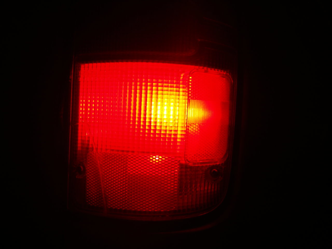

    at night, with parking lights:
    Honestly, I didn't think it would have worked this good, as I was thinking I'd probably end up having to buy a new one, but decided to give it a try, just to see. Pleased with the result :)
