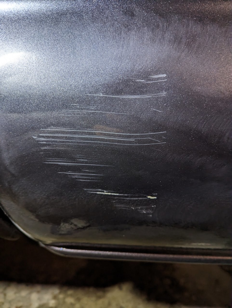

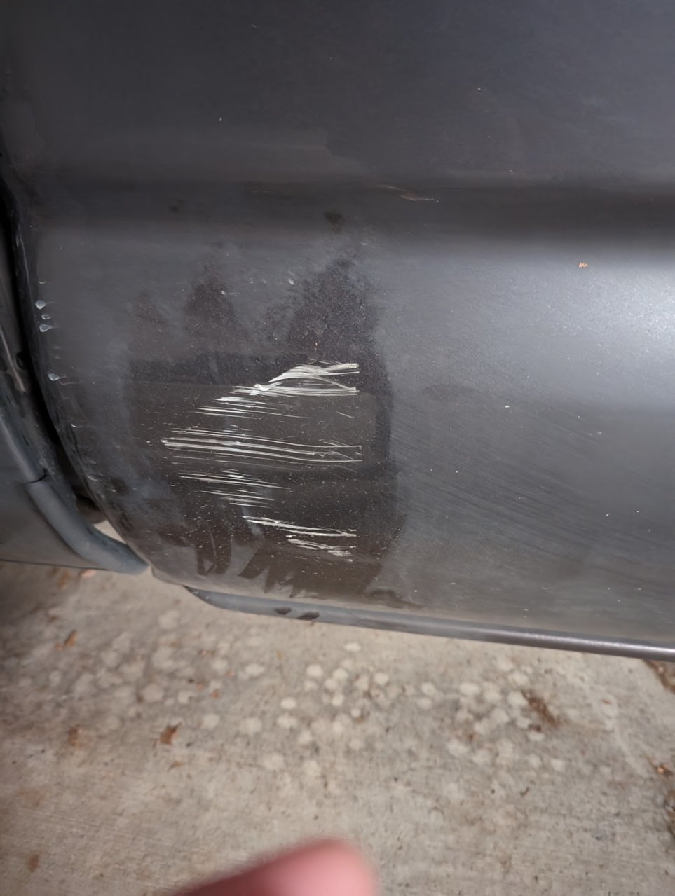

    Original pic from OP:
    Picture from before buffing and after cleaning:
    Post buffing:
    There is one spot near the bottom that is through the paint.

    what buffing, pad, and machine were you using? looks like not enough heat/force/pad friction to correctly move the paint around with the scratches.
    i think it's possible to minimize some of it, but most of it is going to stick around unless it gets professionally fixed and re-sprayed, especially considering some of it is through the clear coat, and those few spots are beyond the clear and the paint. really depends on what you're ok with.

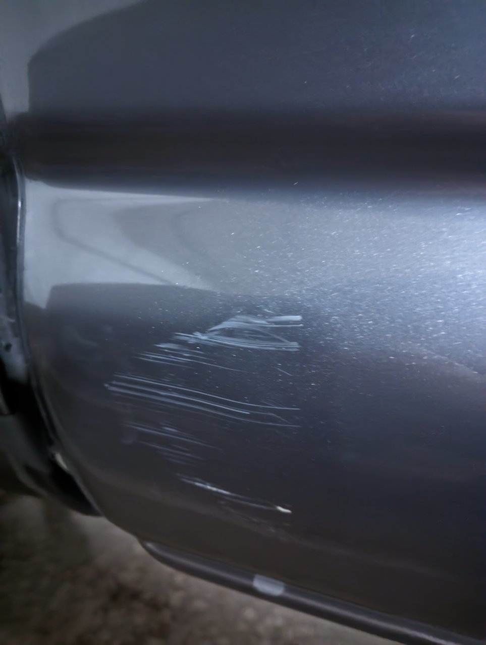

    I gave it a second round of buffing in order to clean up the bottom half a bit more. I think that's all I'm going to be able to buff out. The touch up kit is suppose to be delivered next week.
    Original:
    After the first round of buffing:
    Now:
