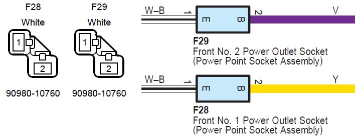

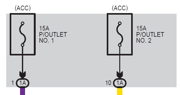

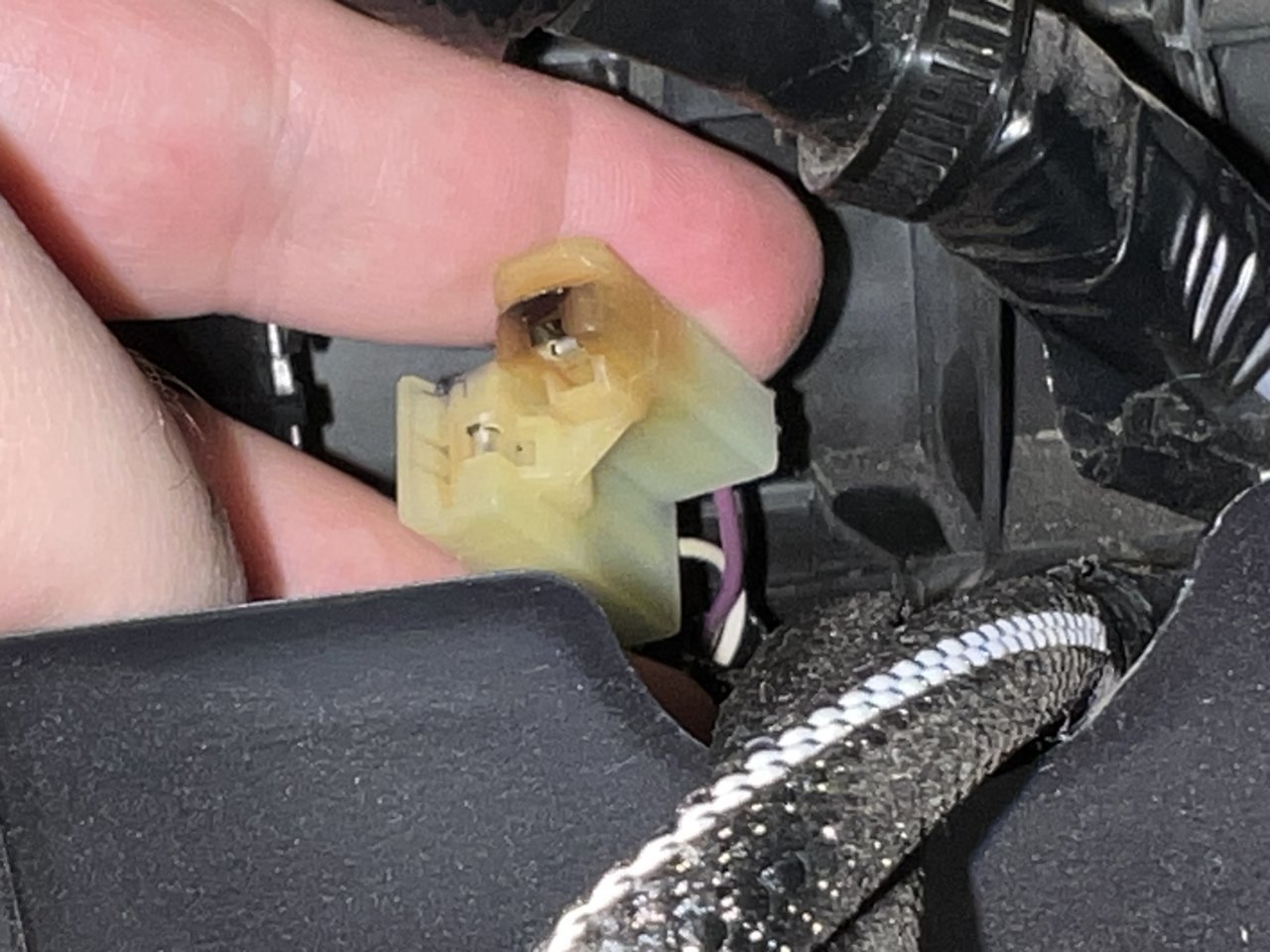

    Somehow I burned out my cigarette lighter. Probably a bad connection. It melted a plug and apparently the connector behind but it didn’t actually burn out the fuse. So I believe the wiring is still good but I need to replace the connector. Any ideas on the best way to do that? I will replace the port itself if it’s bad but the connector is definitely fried.
    for now I’m going to pull the fuse since I assume it’s still hot.

    most of the time these melted plugs are from my current draw

    okay dumb question perhaps... are they not just spade connectors? use to cut them off and replace them with spades and some shrink wrap or the ones that have the wraps around them.

    One cheap way would be to just get insulated connectors at an auto parts store and skip the connector housing altogether. If you want to keep it OEM you could go to a wrecking yard and get the components from a wreck.

    Only "HOT" when vehicle is in ACC or ON.

    Yeah, I actually do think they're just normal spades in a plastic housing. Good call. I'll just strip them and attach new spades. I like the idea of being OEM but when it's behind the dash it's kind of obsessive at that point.

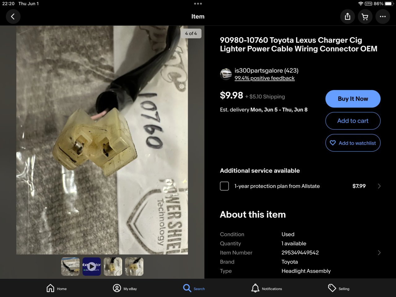

    Wow. I honestly didn’t expect that. Cheap enough maybe I’ll just do that. Thanks!
