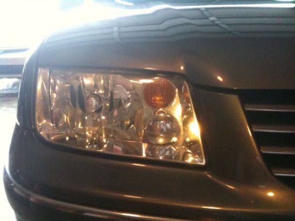

    I can vouch on the 3M kit...used it on my wife's Jetta and it made them look like new. And after every wash I maintain it with that Meguir's PlastX.
    Before:
    After:
