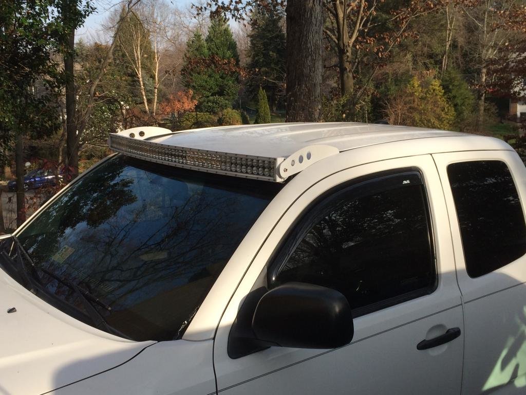

    digging the white light bar and mounts together

    Did something similar on my light bar. I pushed 1'' strips of rubber tubing in between the fins about every 18''.
    Thing is silent now.
    Unless I'm parked with a strong tail wind, I can hear it. Or I back up really fast.
