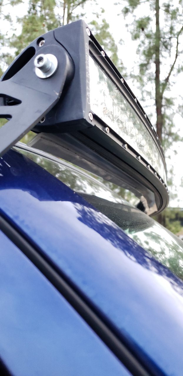

    My bar sits over my windshield, so I’m not totally sure there’s room for this without interfering with my wipers. Can you send pics of how yours is on?
  12. May 9, 2019 at 3:05 PM
    #72
    the_bluetaco
    the_bluetaco Well-Known Member
    Dec 2, 2016
    #203860
    321
    Artem
    California
    2014 TRD Off Road DCSB
    Method Racing Wheels-Double Standards 16x8 Falken Wildpeak AT3W -285/75R16 FRONT: Bilstein 6112, TOTAL CHAOS FABRICATION UCAs REAR: Bilstein 5160, OME DAKAR leaf spring set
    Kinda hard to get a good picture but here it is. It clears the windshield wipers

    This helps a lot, what fin did you attach the deflector too, also, how many did it take to span the whole bar?
  14. May 10, 2019 at 3:25 PM
    #74
    the_bluetaco
    Dec 2, 2016
    #203860
    321
    Artem
    California
    I attached it to the very bottom, i think it took 2 of the door sweep things. It got rid of the horrible vibration but the whistle is still there, I got tired of trying to get rid of the whistle.
