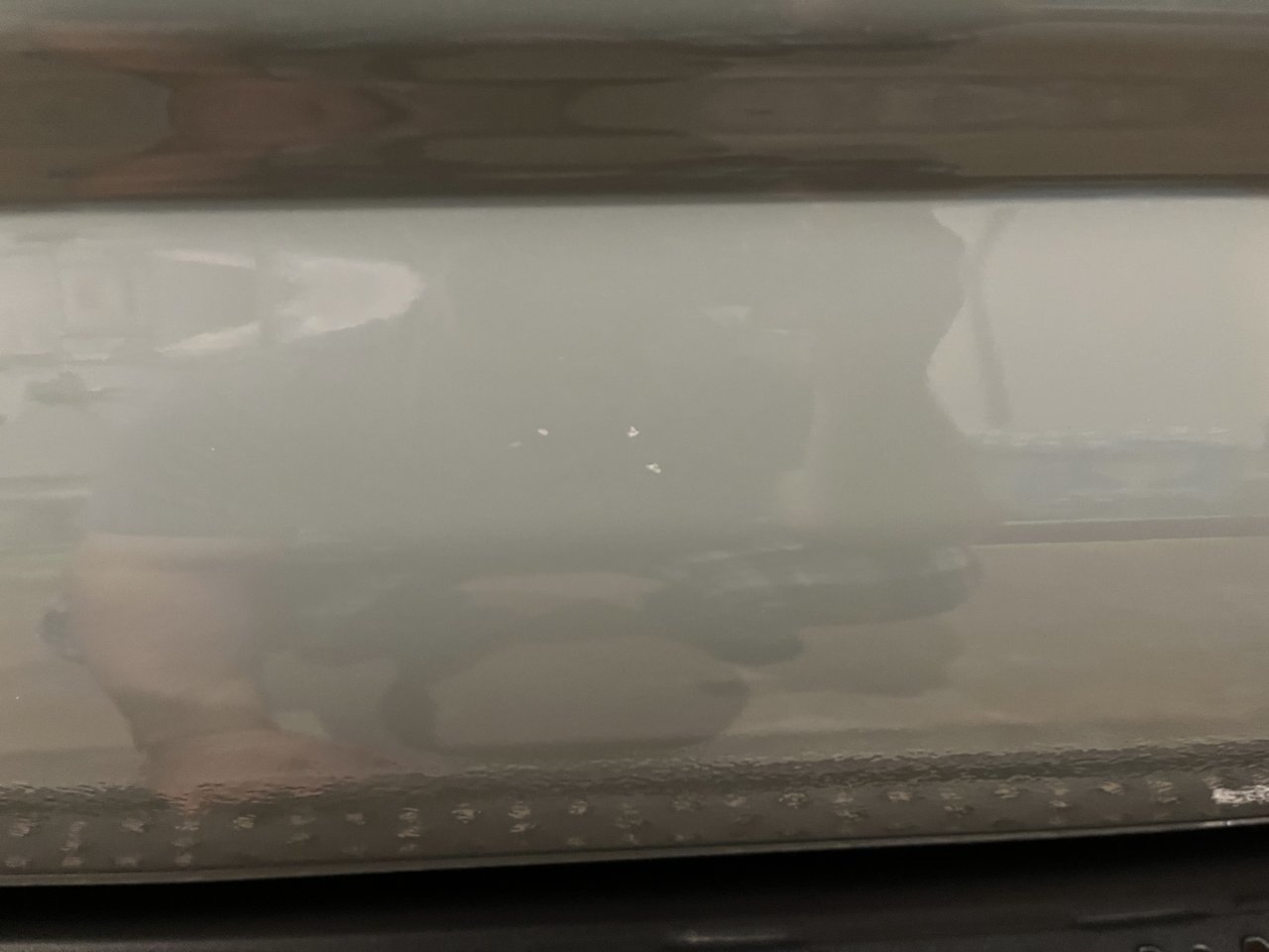

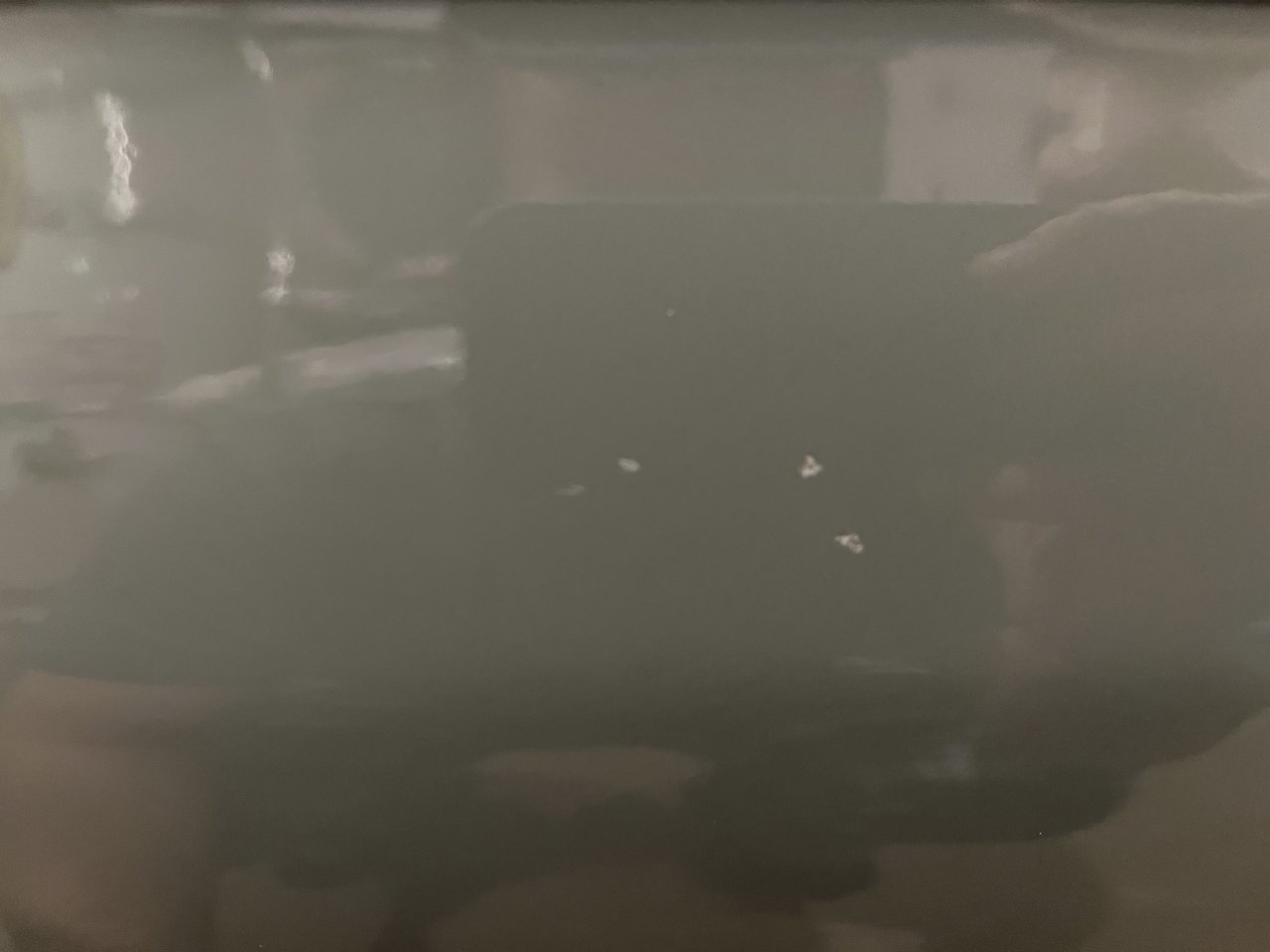

    I was washing my car the other day and while drying it I found rock chips on side of back passenger door.
    my main concern is rust.
    Should I buy touch up paint from Toyota and apply it to prevent rust in future or do I leave it as is?

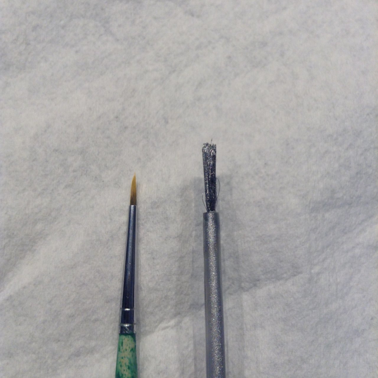

    Don’t use the brush that comes in the paint tube! Get a fine hobby brush and fill the chip in two or three times otherwise it will look like crap.

    Clean the spot. I use alcohol. Use Correct color paint and a #000 brush works good. Found by model paint area at a hobby store etc. It may take several applications to fill in chip. Don’t try to fill chip in with just one application. Work from center to edge. If you don’t like how it looks just wipe off with paint thinner and try again. It will not be perfect but ends up looking better then a chip.
