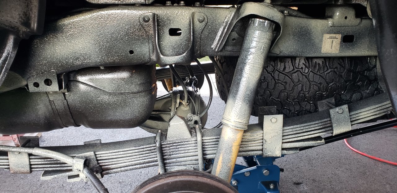

    Ive done it since new every fall. 4 years now in canada.
    I soak in degreaser then pressure wash as much of the old off a day before I re apply. From experience, I use a gallon jug and have about 1/4 left after, floor heater or bucket of hot water like mentioned is your friend. 20191020_175131.jpg
