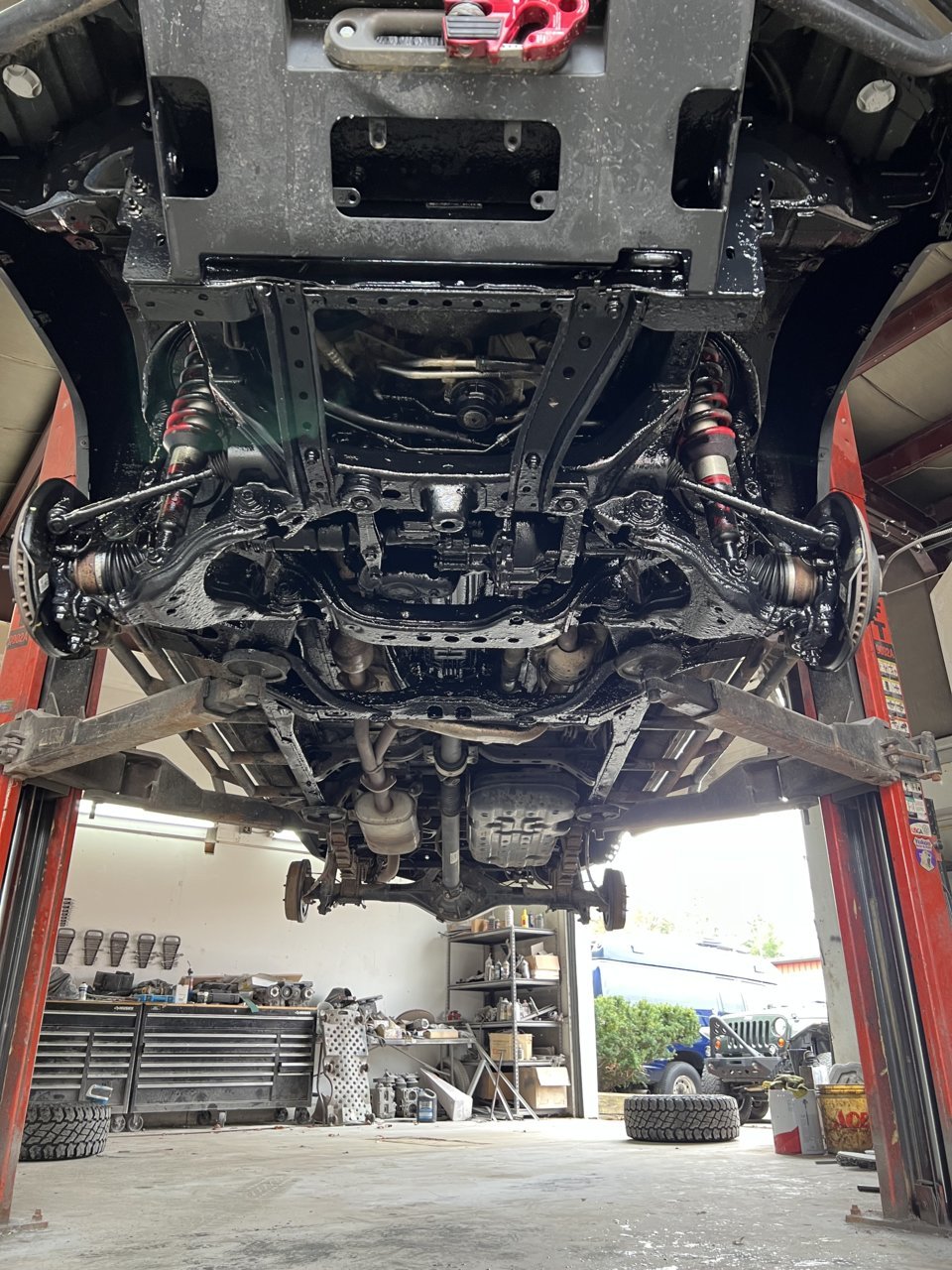

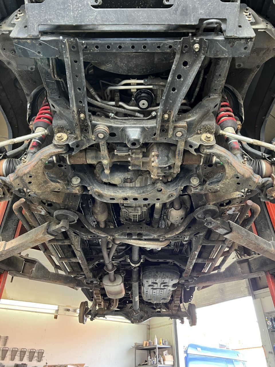

    Woolwax day. Spent hours trying to wash all the dirt off. Finally just sent it. Changed all the fluids before I did it also. My OCD ripped through all 12 cans by the time I got to the mid point. I FLOODED all the crossmembers. But the front is done, and that’s the part I really wanted the lift for. Another 12 cans on the way.

    Should of done your lift arms while at it.
