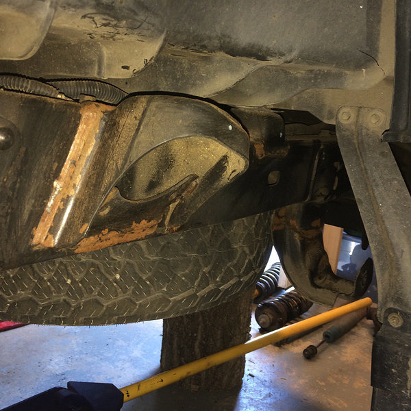

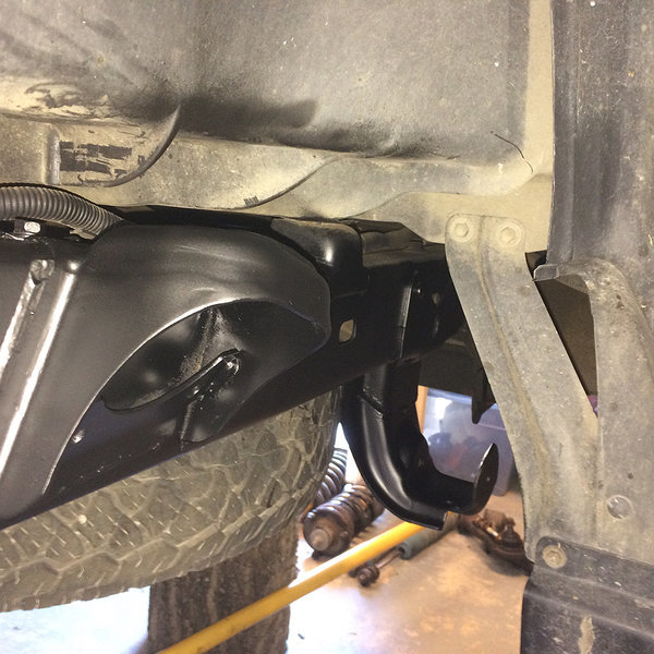

    My truck wasn't rust-free when I bought it in 2015 and rust never sleeps. It was about one of the least rusty trucks I looked at so I'm trying to keep it clean. But nothing stops it forever. My last truck got a Fluid Film once a year before winter and it was fairly rust free at 25 years old but even it wasn't pristine by far. I will say that in 1991 Toyota did a MUCH better job building and painting the frames. No comparison. But that truck was made in Japan, which I think makes a huge difference.
    This is the sort of thing I fix when I can. After painting and coating it I still find little spots of rust coming back every spring. Rock chips, coating with magnesium chloride for weeks on end, the power washing, the Fluid Film can't last but it does slow it down a lot.
