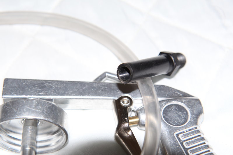

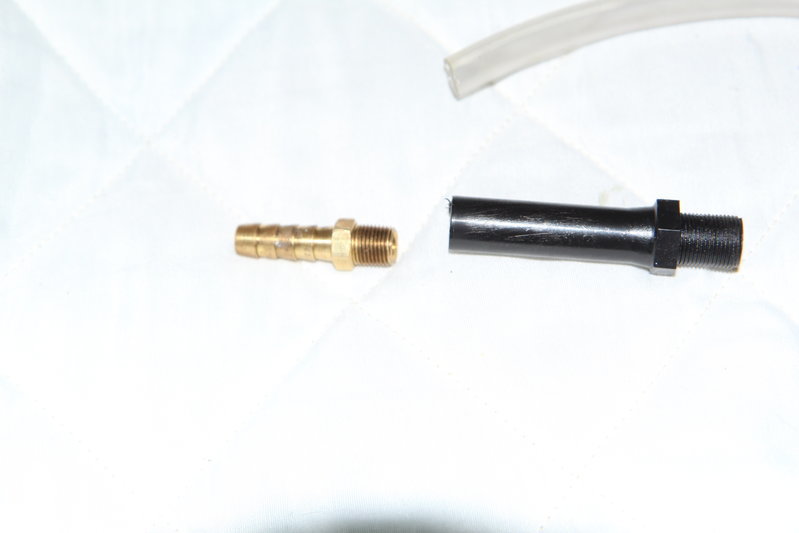

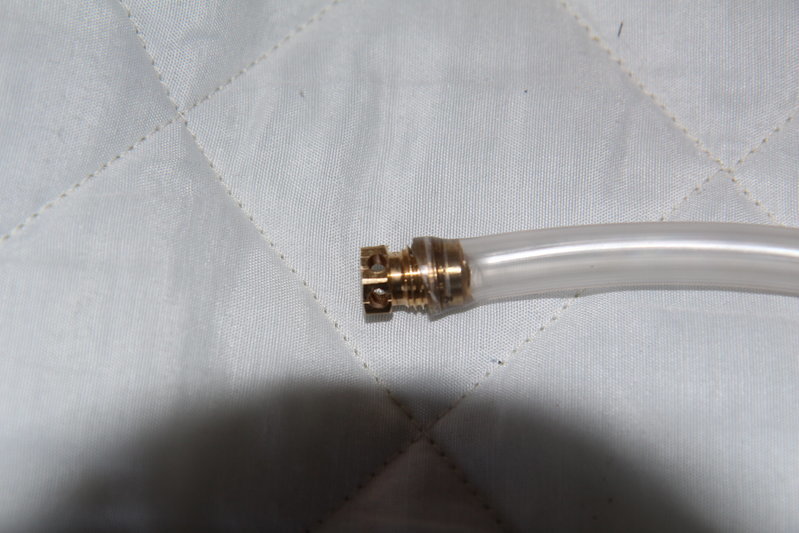

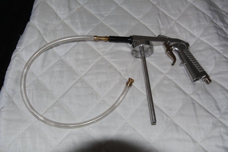

    I cheaped out . the FF plastic fitting is a bastard thread ( 1/2- 27? not quite a 1/2-28 according to my thread pitch gages ) to fit into the gun . I had the tools needed to modify the gun so I drilled out the end of the plastic fitting for the FF gun with a 21/64 drill about 1 " deep , then tapped it out with a 1/8 x 27 pipe tap . Now i can use any standard 1/8" pipe fittings and pipe for extensions etc.
    The last pic is an end plug for air or fluid I found at the hardware store , I drilled a hole on each flat to make a 360 degree end to use for the doors and rocker panels etc.Cost me about $4 IMG_0784.jpg IMG_0785.jpg IMG_0788.jpg IMG_0790.jpg

    That's slick. I got the wand with my undercoat gun but if I didn't your solution looks at least as good and maybe better than the manufactured one. The thread and pitch variance might be a metric to imperial thing. My gun says made in Italy.
