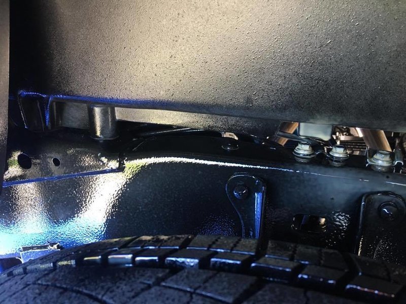

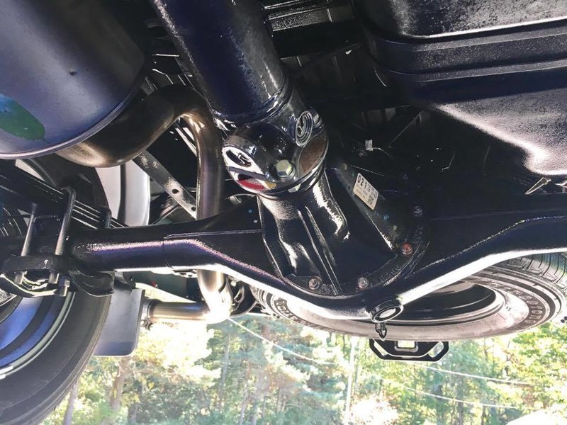

    20161115_153637.jpg 1 year old, 2nd winter spray applied. no rust
    Used 6 cans when they went on sale
    Took about an hour
    Jacked up the front end to give more room
    Removed skid plates
    Warmed cans in hot water prior to use
    Did in driveway no mess but you will get caked in over mist so wear shitty cloths
