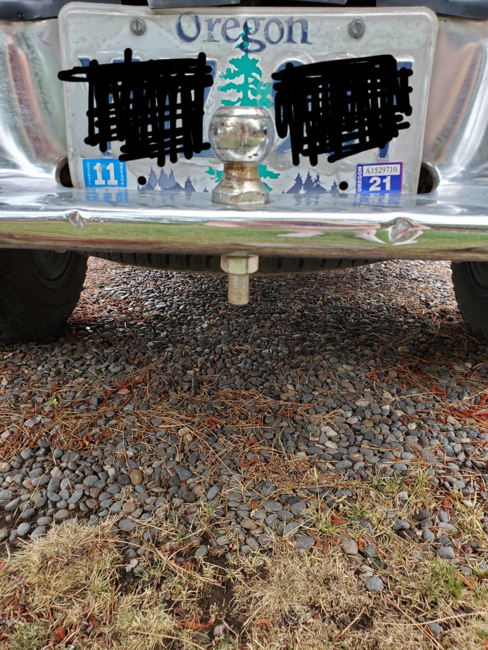

    I'm trying to figure out the cheapest/easiest way to put a flag pole where my trailer hitch goes. Are there any products I can use or can I just stick one in that hole?

    Assuming you mean the bumper mount hitch ball, as your truck doesn't seem to have a conventional hitch/receiver. My suggestion would be to simply take some plate, 3/16 or so, and fab a right angle bracket. Drill a whole in one leg that will allow the ball bolt to pass through, and then drill the vertical leg for a couple of small u-bolts or through bolts to hold the flag pole in place. Remove the ball, place the bracket on the hitch and then bolt it in place using the hitch ball. Job done...
