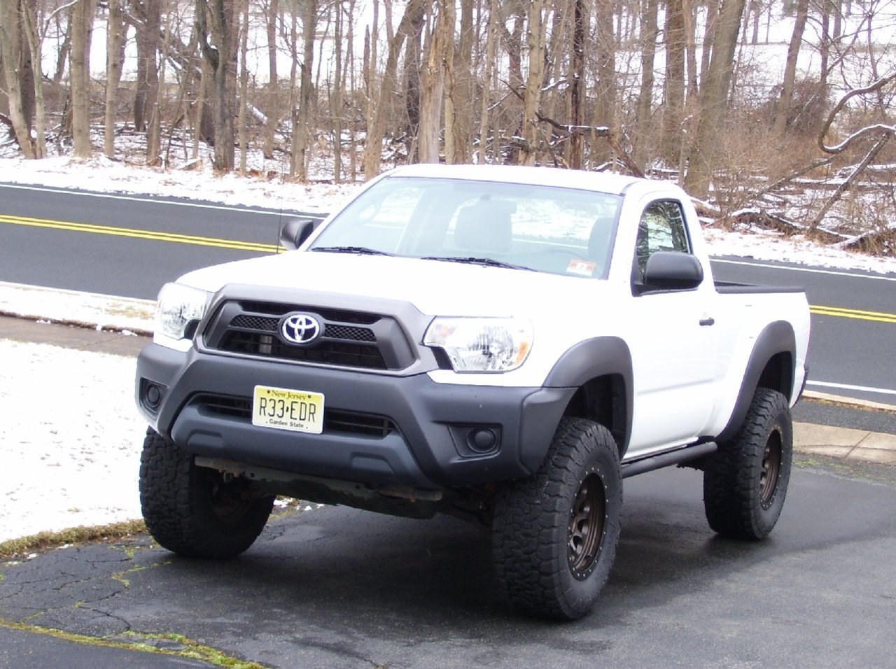

    You can run a wider wheel with some negative offset and wider tires. But at some point, you will run into a problem with the tire rubbing on the cab mount if they stick out too far. My wheels are 17x8.5 with -10 offset and the tires are 305/65/17. I get some slight rubbing at full lock but my truck also has about 3" of lift and SPC upper control arms which can be adjusted to push the wheel forward in the wheel well.
