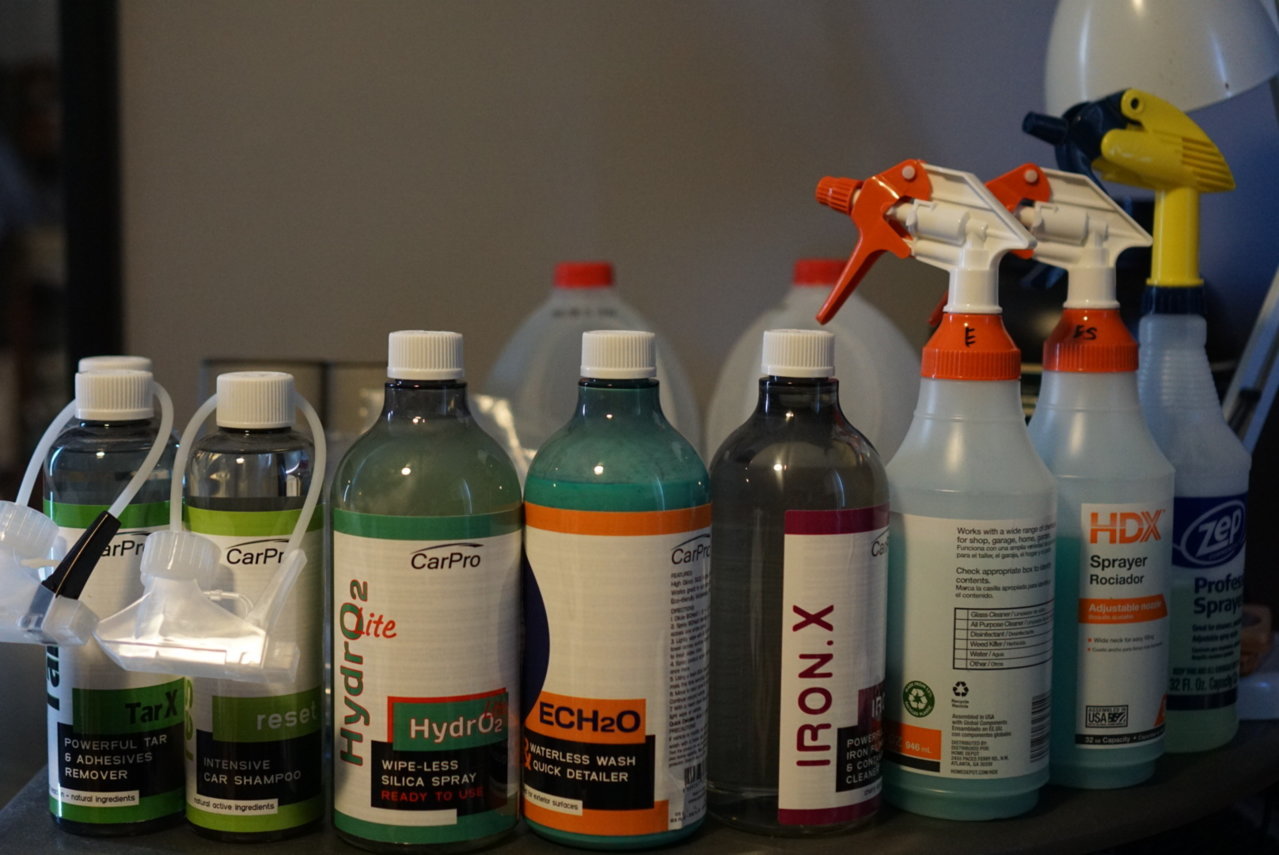

    So you're saying you're a Car Pro.
  8. Jul 20, 2018 at 3:34 PM
    #28
    oscolivar1
    oscolivar1 Well-Known Member
    Oct 30, 2013
    #115568
    2,267
    Oliver
    VA
    2017 Tacoma Limited
    Bilstein 8112/8100, JBA UCAs, Icon RXT leaf pack, work wheels 17x8.5;-10os, 285/75/17 cooper LTX AT3, Mobtown HC rear bumper and Sliders, SSO front bumper, BAMF greceased grill.
    Fanboy of carpro products :spending: :anonymous:

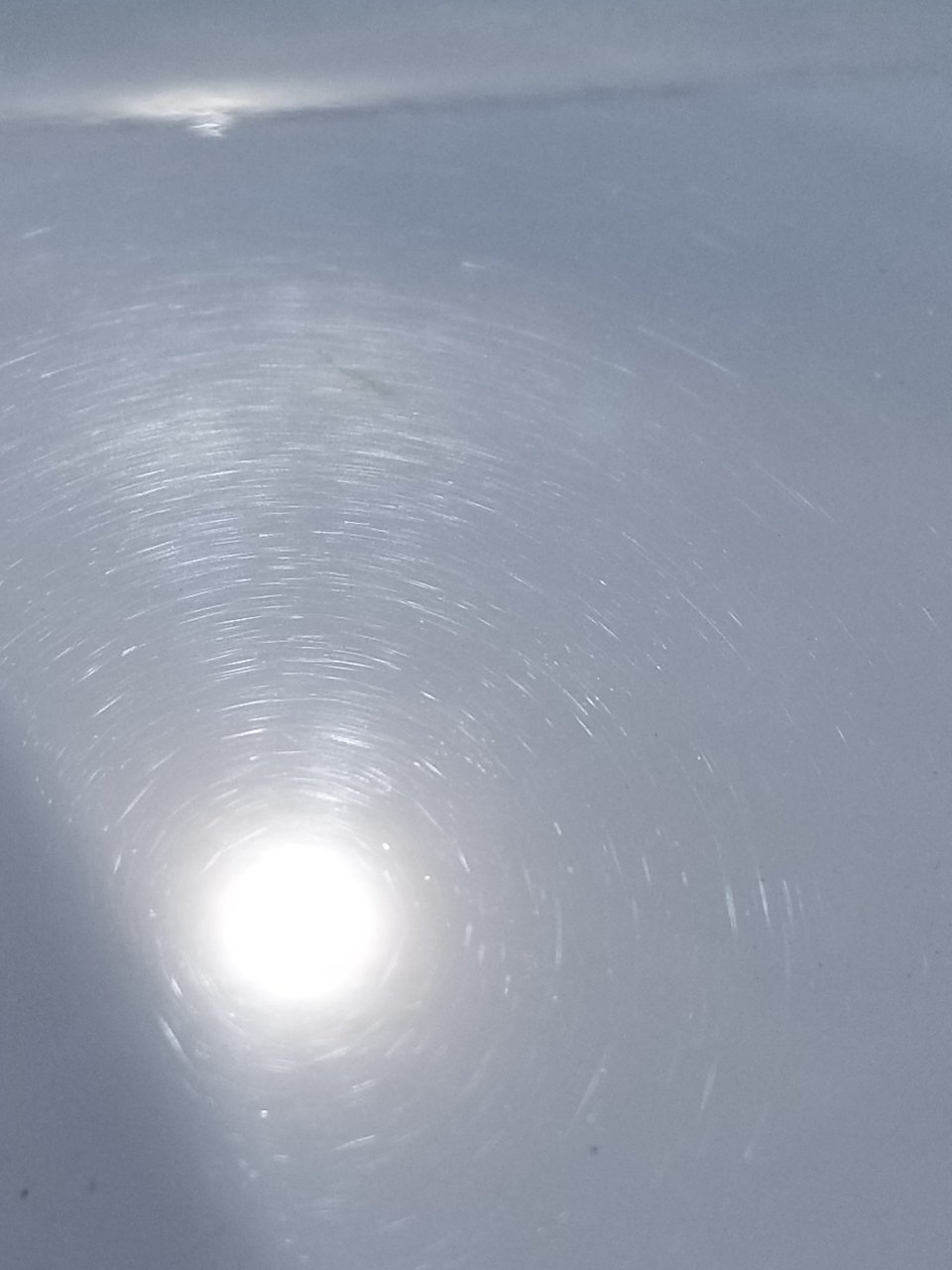

    Just noticed a bit if swirl and hazing from my prior attempts. Will scratch x 2.0 remove this too or should I stop and seek a professional?

    Yes it will also remove the swirling.
    Honestly, you’ll do best with a machine. I highly recommend Porter Cable 7424XP. Its about $120. Great little machine you can use for detailing work (and other things, I just bought a home and I plan on resurfacing my shower inserts with it).
    I recommend it because its very difficult to paint correct by hand and takes a tremendous amount of work. A machine is much better and faster. Plus some levels of correction you just can’t acheive by hand.
    A polisher, backing plate, set of polishing pads, polish, and a set of quality microfiber towels will run you about $275.
    In my area you’ll typically pay about $300 for an exterior detail with 1 level paint correction (for the whole Tacoma).
    Now detailing work is addictive so it ends up costing much more over time LOL. My arsenal is probably tipping $1,500 but I did some side hustle detail jobs to pay for it.
    If detailing is something you think you’d enjoy I recommend spending the cash for the machine and essentials. It will pay off in the long run. You’ll want to polish once a year to remove swirls and you’ll always have little oopses youll want to fix. Always paying a pro is expensive.
    But if it doesn’t appeal to you, go to a pro. They’ll take out the swirls and the etching.

    So I took it to the detailer this morning and he tried everything up to and including wet sanding with no results. He cleared off the scratches I made myself but told me it's Type 2 etching which has sunk under the clear. Since my paint is 1-stage didn't advise going further.
    He told me that this may possibly fade out over time completely or to where it's not as clear.
    Next stop was the dealer, service manager straight up told me this isn't covered on warranty and he thinks applying a lot of heat could make it evaporate.
    So here's where i'm at. At least now the scratches are gone but I don't know whether to leave it and hope the sun fades it or get those graphics.
