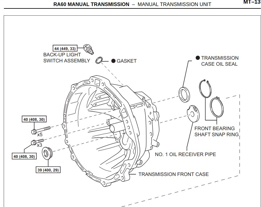

    The bell housing isn't a separate piece on the RA60, it is part of the front transmission housing.

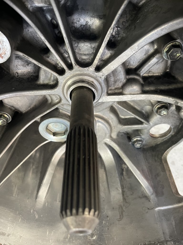

    Snout broke on transmission any options besides new transmission?

    I'm assuming you're talking about the part the throwout bearing rides on?
    I'm not sure if there are any repair options for that or not, @6 gearT444E or @gearcruncher may know.

    It looks like you would have to replace the Transmission Front Case.

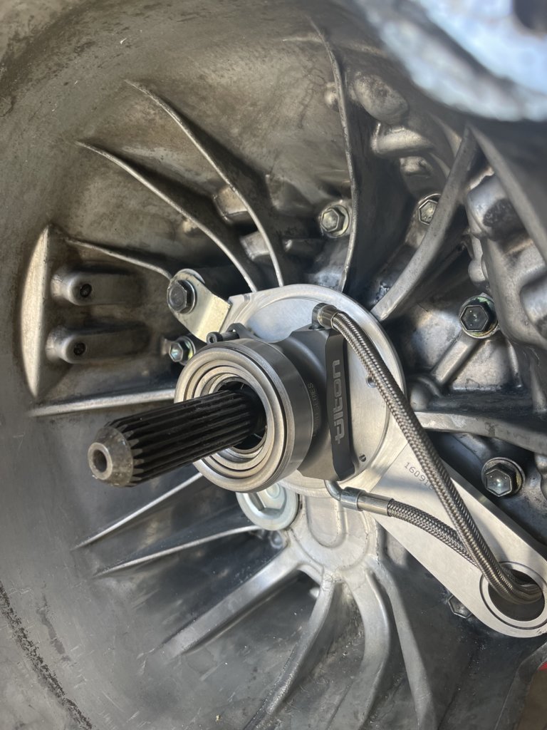

    the URD kit is the only option I know of that’s still being made. There was another kit that skips my mind at the moment I’ll think of it eventually though.

    I'm no doctor...but...I'd imagine some words to accompany these photos might be more helpful to OP and any other interested and curious parties?
