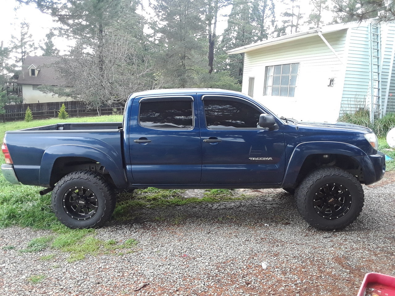

    Here is my baby, always wanted one and finally saved up enough to get it, paid 14.5k20180322_173232.jpg
