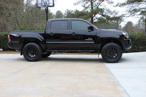

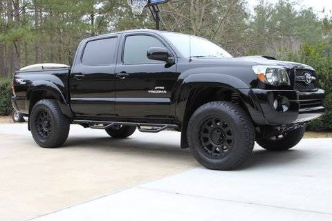

    Any way you could take a pic of the front and rear suspension setup?

    have 4 leaf pack just done 3 days ago. as for pics underneath or to the side. I have pics in gallery of side the ones with the trd emblem on side are with lift. Thanks

    Maybe it's just me but you look slightly nose-high in all of the pics in your gallery. If anything I'd lift the rear a little more, not the front.

    you probaly can't see it from the pics but the pavement my front tires are on is starting to grade up into the garage. Thats why those pics look that way.
