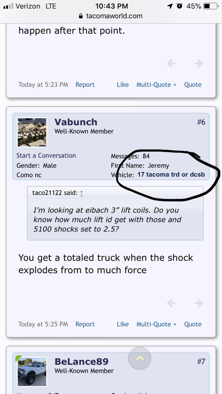

  6. Jul 26, 2019 at 3:25 PM
    Vabunch
    Vabunch Well-Known Member
    May 10, 2018
    #253062
    461
    Jeremy
    Capron va
    17 tacoma trd or dcsb & 96 tacoma scsb
    You get a totaled truck when the shock explodes from to much force
    Running Board Man likes this.
