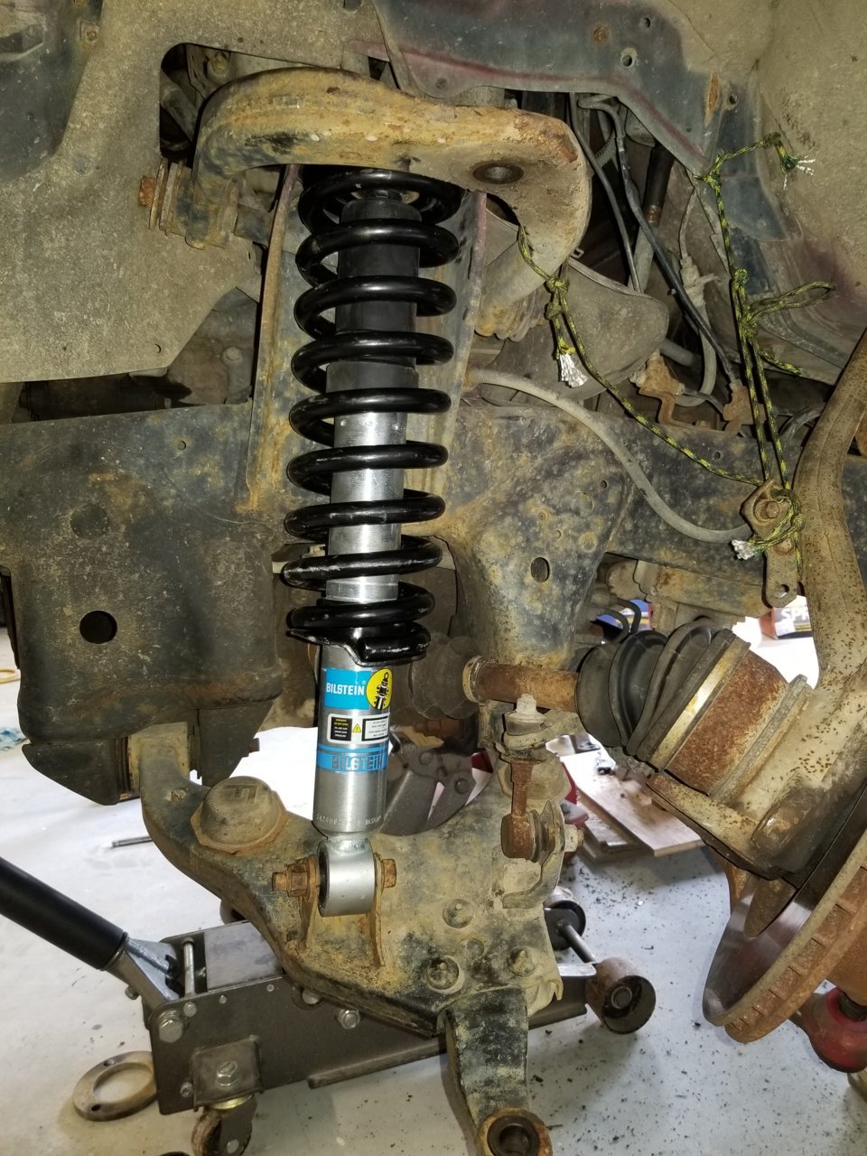

  11. Jul 27, 2019 at 8:03 AM
    #31
    Kwikvette
    Feb 27, 2019
    #284735
    82,255
    Fresno County
    4 run, 2 don't
    Sorry to deviate, but even your bump stop has rust!
    Holy shit.
  12. Jul 27, 2019 at 8:35 AM
    #32
    taco21122
    taco21122 [OP] Taco2.7
    Sep 14, 2016
    #197277
    150
    North Carolina
    2002 tacoma DC Prerunner 2.7l
    5% tint 32” LED bar New DEPO headlights Pioneer radio Kicker speakers Bilstein 5100’s 20x10 fuel turbos 295/55/20 toyo rts
    That’s a little higher than I wanted but how much and what kind is it

  16. Jul 28, 2019 at 7:01 AM
    #36
    taco21122
    Sep 14, 2016
    #197277
    150
    North Carolina
    So get those coils and set the bilstein to the middle setting to get around 3?
  17. Jul 28, 2019 at 7:16 AM
    #37
    G59
    G59 Stock af
    Jun 22, 2016
    #190277
    411
    Torres
    SoCal
    03’ Long Travel DC
    You're gonna over exert your suspension by using a maxed out 5100 shock and spacers, you can use a coil spacer or anything else but you'll be on thin ice.
    I do not recommend a body lift at all. (If you do, pray that steering wheel doesnt crush you if you get in a front end collision)
    Best way to get more lift honestly would be an aftermarket uca and a bigger shock. Bigger tires will also give you some lift.
    Don't cheap out on suspension.
    Kwikvette likes this.
