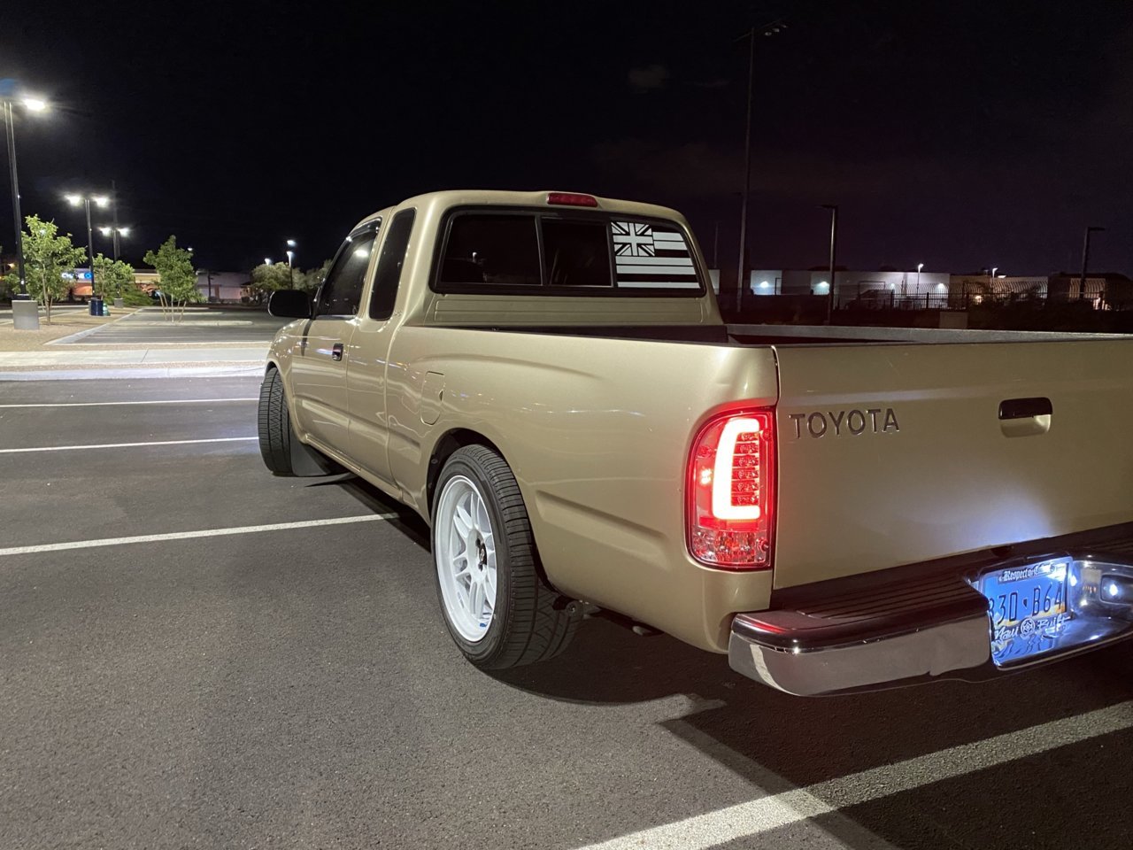

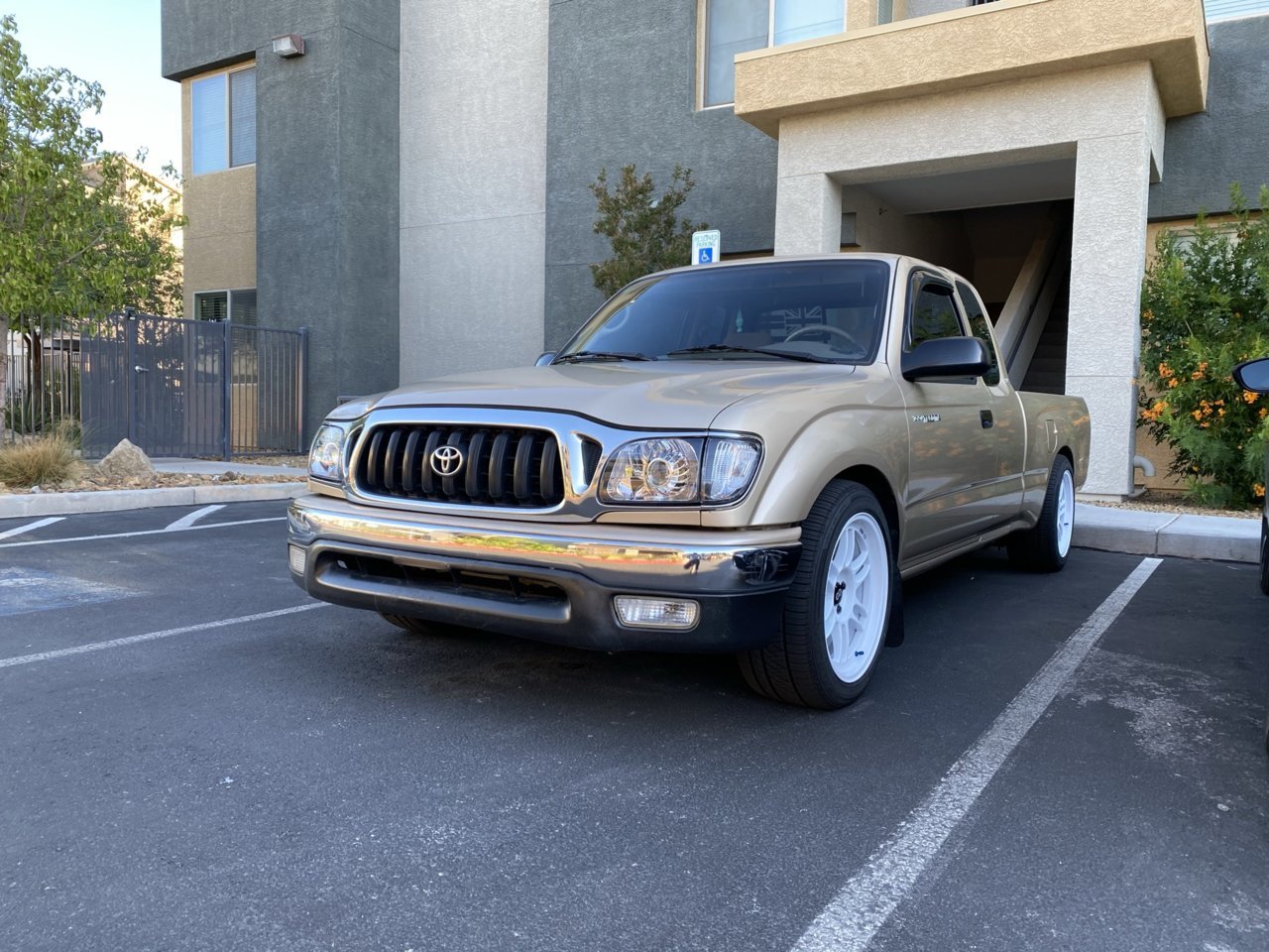

    275
    Ok so you did the djm up front did you flip the ball joint as suggested in the kit? If you did then to really get it where you want it I the front I would suggest doing the coil over setup. For the rear you can get lower with blocks but without a notch if you carry any weight the diff will tend to hit the frame

    Thanks a lot still a lot to do on her! Those are stock prerunner flares I added
