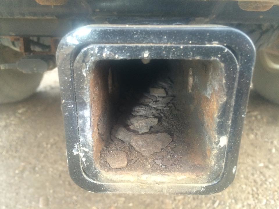

    Finally got it! This is the rust flakes leftover in the receiver. I let it soak in blaster for about 2 weeks, then broke it loose with a 20lb maul. Then tied it around the tree again and yanked it out. Took 4 tugs to get it to come out, it was wedged in there pretty good.

    So glad to have that ugly thing out!

    Thanks, there was a lot of dirt in there too. Like the previous owner backed it into an embankment and it got packed full of mud. That definitely didn't help the rust issue any.
