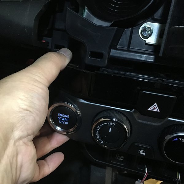

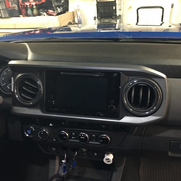

    Ok, so I searched on how to get to these buttons and found some people just taking the stereo out and reaching all the way down to push the buttons out. I don't have skinny girl arms so that doesn't work for me. Years of installing car stereos and taking dash boards apart got my curiosity going and I got bored and finally figured out an easier way to get to the buttons.
    First off, the bezel around the stereo just pulls off. (I'm sure most everyone knows this)
    https://www.tacomaworld.com/attachm...4/?temp_hash=879c1825fe84560c39fedda8d10ca71e

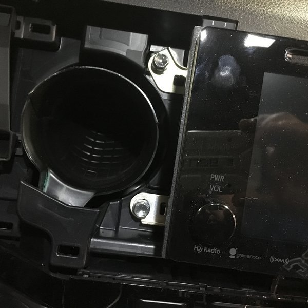

    Then you undo the 4 10mm bolts holding the stereo in.
    https://www.tacomaworld.com/attachm...6/?temp_hash=879c1825fe84560c39fedda8d10ca71e

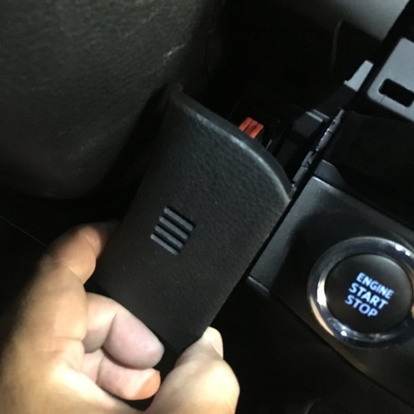

    Now you gently pull the right side of the cover under the steering wheel. If you pull gently by the mic, it comes right out. Clips are all that hold that thing on.
    https://www.tacomaworld.com/attachm...7/?temp_hash=879c1825fe84560c39fedda8d10ca71e

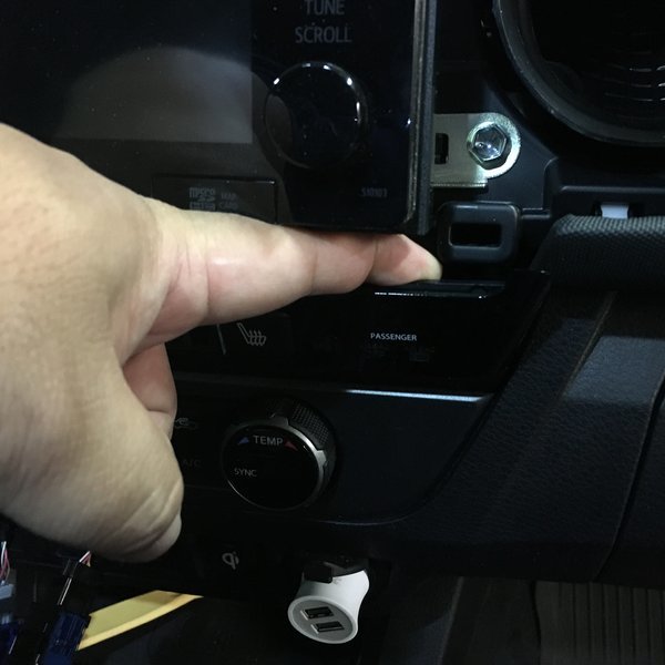

    Next, gently pull on the climate controls. I started on the right side and worked my way toward the drivers side.
    Once you get it out, there are 3 connectors for the climate control. ( At least there were 3 for my model which is the OR)

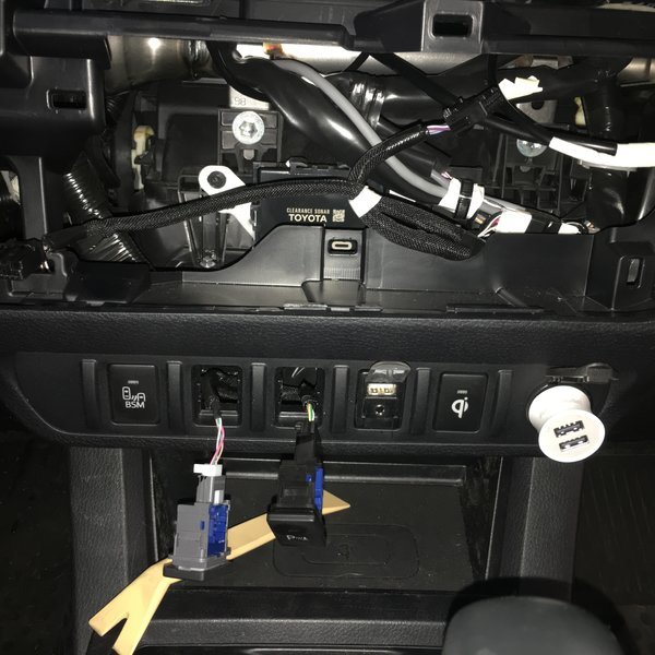

    And bam! Its super easy to reach behind the buttons to push them out. The actual bezel that they are mounted it is part of the dash board and after looking at it, it looks like kind of a PITA to take off. This beats trying to reach into your dash, elbows deep trying to push out switches any day and it only requires removing 4 bolts.
    https://www.tacomaworld.com/attachm...5/?temp_hash=879c1825fe84560c39fedda8d10ca71e

    #1: I found it easier to remove the climate control panel on my P&T equipped truck if I loosened the top radio bolts and removed the bottom radio bolts so the radio can shift out of the way
    #2: It looks like removing the switch panel itself requires removing the glove box, the passenger knee airbag assembly under the glove box, and a couple other bits. Pretty involved as you surmise.
