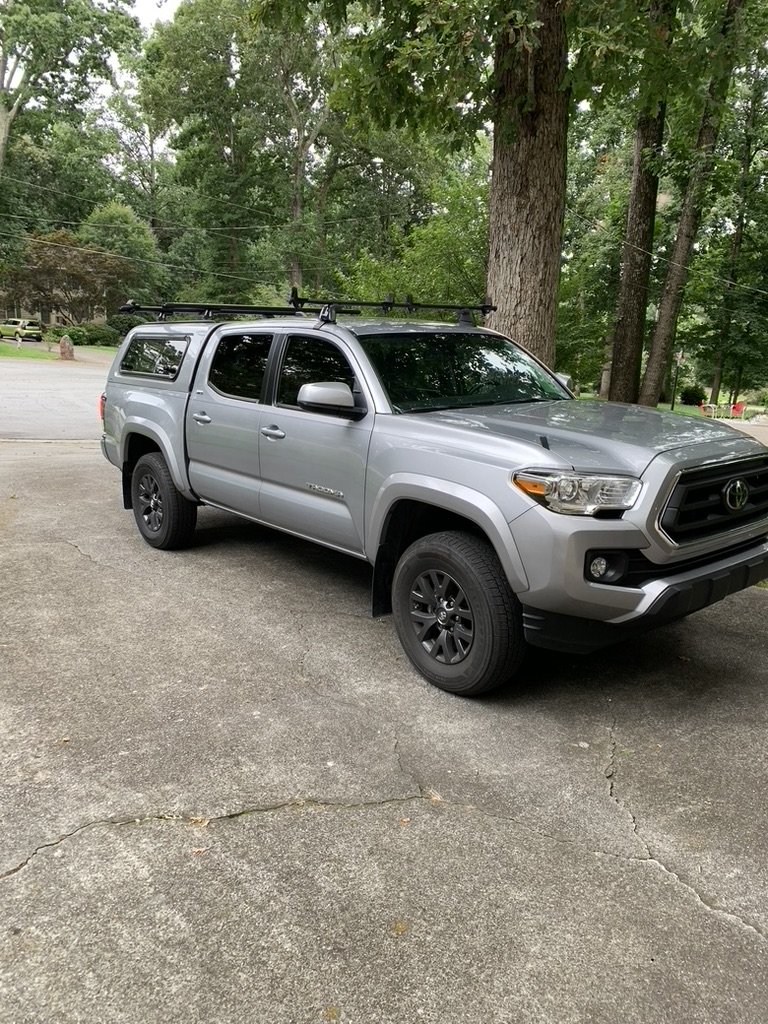

    I haul canoes and kayaks that vary in length from 8' to 16' long. I recommend using a single cross bar over the front of the cab and a single bar on the Yakima rails. My 12' lg. Esquif Adirondack canoe fits perfectly on the front cross bar and the rear cross bar on my ARE shell. The cross bar on the shell can be positioned on the tracks to best support your boat. I have the HD cross bars on Baseline towers on the shell and a single round bar on Baseline towers over the cab. The three cross bar system works for all my boats, but you may only need two crossbars if you are only carrying 12' long boats. As noted by @PacoDevo, do the math to center your boats and set up your racks for the minimum overhang.
    You can use which ever cross bars work best for the boats you plan to carry on your truck. Go to a good rack dealer to help you determine which racks will work best for you!

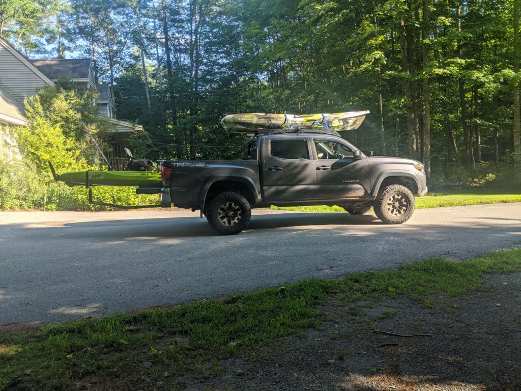

    Multiple ways. An extension off the receiver works well for the bigger stuff. That's 13' and has room to go
