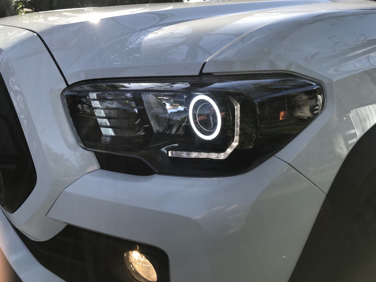

    I just did my 3rd gen, used the Morimoto switchbacks. Real pain in the butt. Final results are nice though.

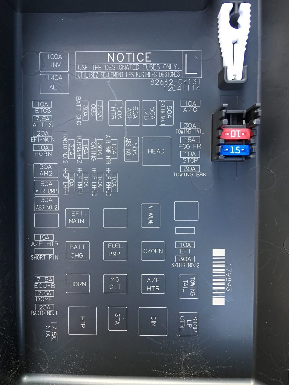

    Curiously, what fuse did you tap into? I don't have the EFI2 as stated in the tutorial. I tapped into the EFI but I'm getting CEL with Error codes (P0031, P0102, P0416, P144C, P1600, P1300, P0051) and the Traction Off light is on as well. I have the switchbacks, but the white/DRL function is not working, just the Amber/Blinker.
  17. Mar 18, 2018 at 8:42 PM
    #77
    kustom54lighting
    kustom54lighting [OP] Well-Known Member Vendor
    Jun 28, 2015
    #158371
    1,293
    You should have EFI2, but the reason your getting the code is because your suppone to add two fuses to the tap a fuse and sounds like you only added one
    JDB02[QUOTED] likes this.

    Thanks @kustom54lighting , I definitely overlooked the second fuse. That solved all the CELs. However, still not finding EFI2. I have EFI-Main and EFI. I tapped into the EFI fuse for now and everything is working as it should.

    Wierd yours is EFI, on our truck it's called EFI2
