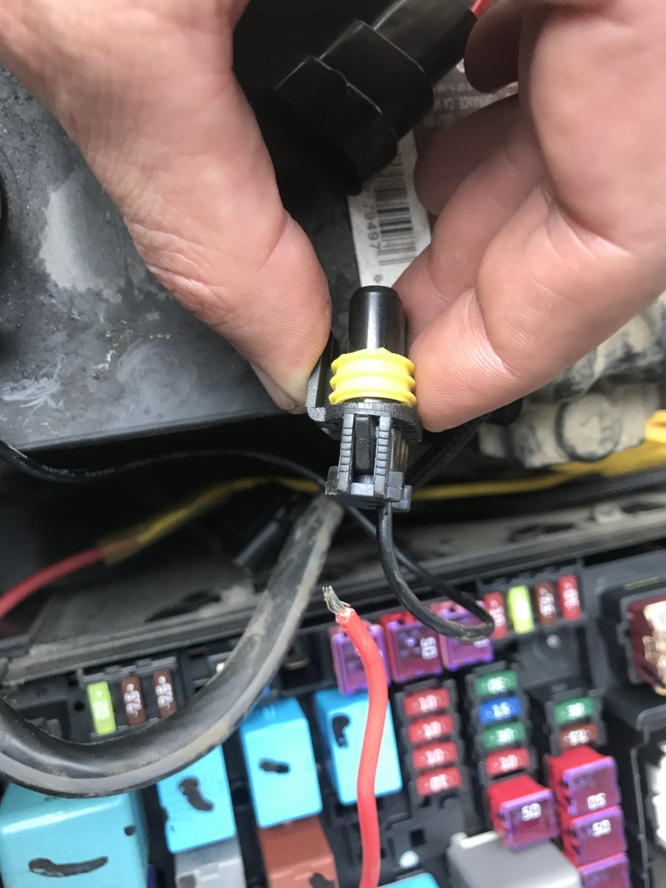

    Hmm, where are you guys mounting the motocontrol box?

    We bend the tab and mount it on the battery tie down

    You're a genius!! Why didn't I think of bending the tab? I would assume I'd have to add a nut over it to keep it snug and from bouncing around on rough roads, yeah?
    I've got them installed and adjusted. Love them. Being a non-electrical guy I can't believe how easy the install was. Thanks!

    How screwed am I?
  17. Sep 1, 2018 at 8:05 PM
    #97
    kustom54lighting
    kustom54lighting [OP] Well-Known Member Vendor
    Jun 28, 2015
    #158371
    1,293
    No sir that connector can be by passed and you can just splice to the power wire on the harness where it originally connected

    Got it figured out, thanks.
