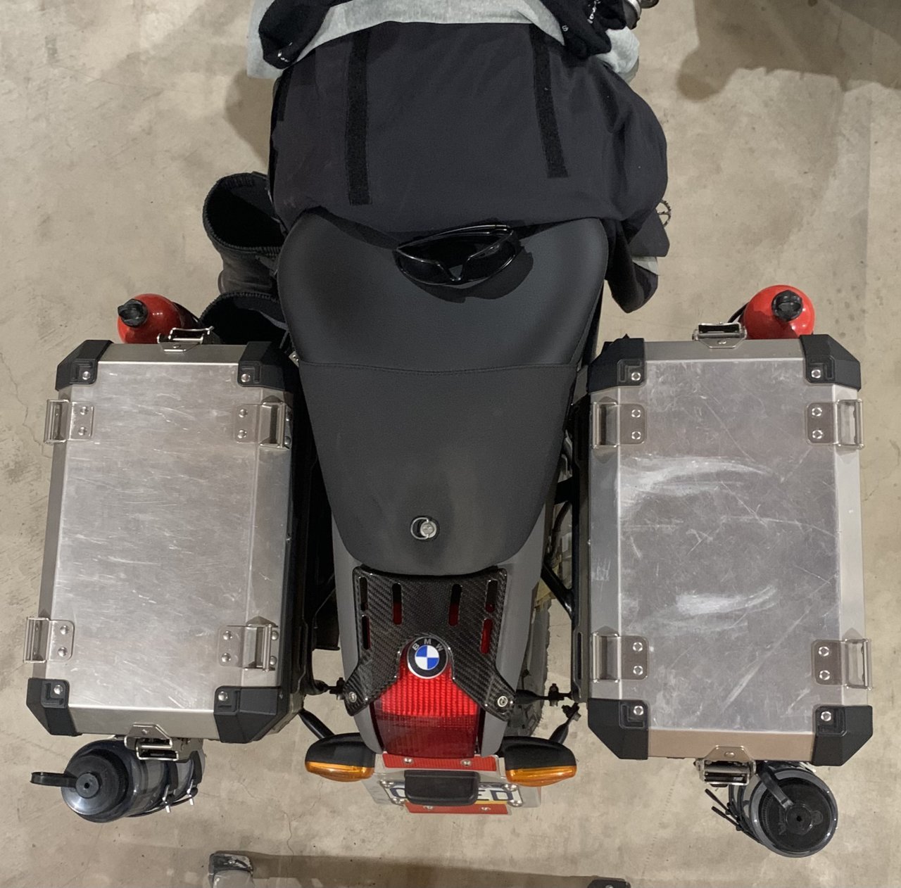

    Packing for bike touring is a different beast. It's way closer to backpacking then car camping. lol

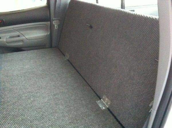

    anyone who has converted the back of their double cab to a platform, do you regret it?
    I want to see if I can make one with my leftover 3/4” plywood from my DIY bed platform (unless this is too thick and unnecessarily heavy)
    35L fridge atop my back seat barely fits and kind of sucks because it tilts upward at an angle making things inside fall over and squish each other. Already had a bottle maybe not sealed the best from the grocery store leak.
    Using a platform would give more room and a flat level surface.
    but I might not have the room to be keeping spare parts (like seats) in storage and rather just throw them out.
    No idea what a junkyard would charge to buy used ones later on down the road if I want seats back again.
    They’d probably overprice it just like anything else 2nd gen Tacoma.
    The cons are; getting rid of seats would mean less ability to take people off roading.
    For example, I have had times where I empty out the truck and am able to take friends, family, etc on a fun trail
    less seats means less ability to do that
    Or only having the front passenger seat for +1 person

    The platform sits on top of the folded down rear seats, you don't get rid of anything. 3/4" plywood is going to be pretty heavy. I used 1/2" for mine and it is more than enough.

    I stripped everything out and built one. So much room, never going back. It’s just two of us always and maybe a little dog sometimes. Fridge is in/on it full time.
    One other thing you might consider (I ran it this way first) is to delete one seat. I did the 60% side for a fridge, it worked fine but led to the full delete and the floor space is amazing.
    I wouldn’t get rid of the parts though but that’s just me. I would try and figure out someway to store them.
