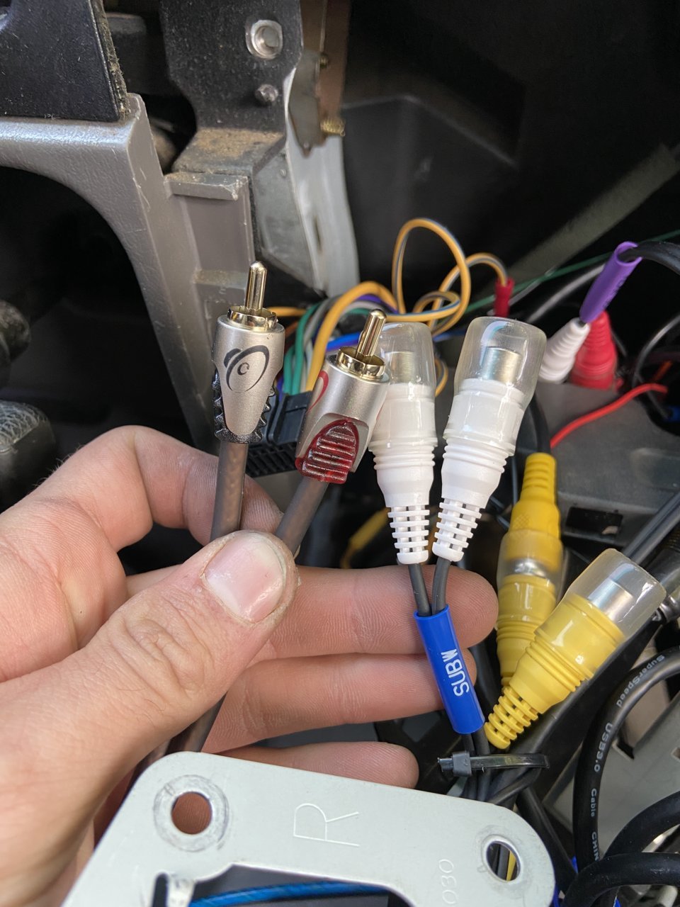

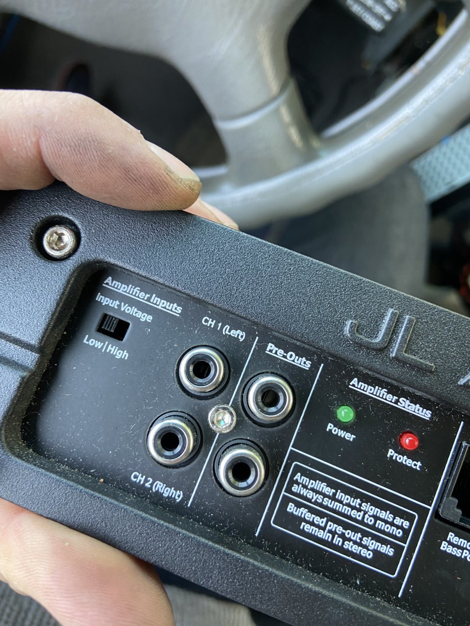

    I put another picture on the OP, I’m wiring two subwoofers together. Can you tell me which of the four plugs to use on the amp?

    Use Channel 1 Left and Channel 2 Right. Other Pre Out is there if you are planning on running more than 1 amplifier in your setup.
