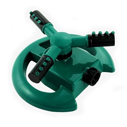

    This turned upside down, on top of a furniture dolly, for easy maneuvering.

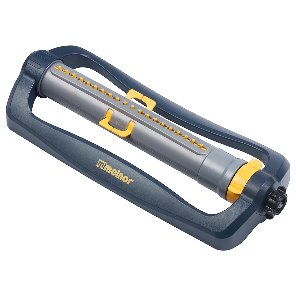

    This is like the one I use. 15 min front 15 min center & 15 min rear. Has worked for me successfully for many years of living in the rust belt. As for the poster saying we are wasting water...just a thought, we are all drinking the same water over and over again....Yes Clark we are drinking Dinosaur piss.o_O
