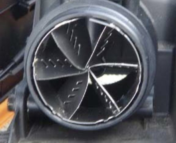

    This was the increase MPG go to for a while right? Or was it HP? I forget.

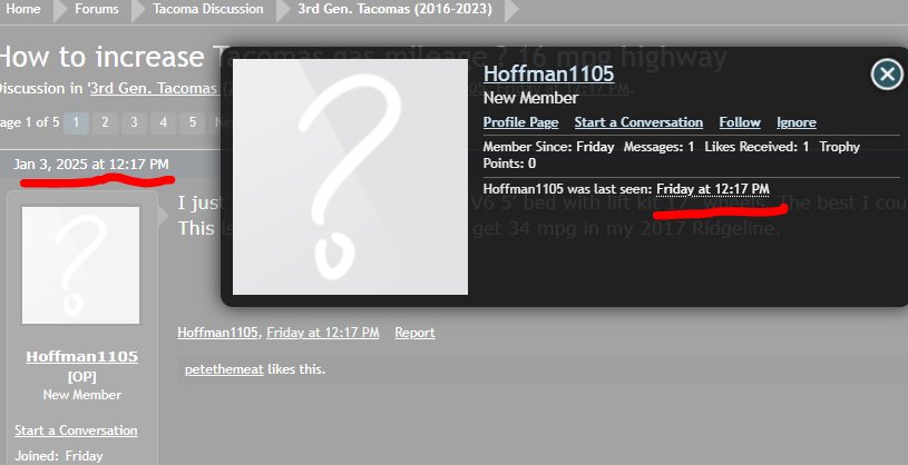

    The troll won't be back. 100%
