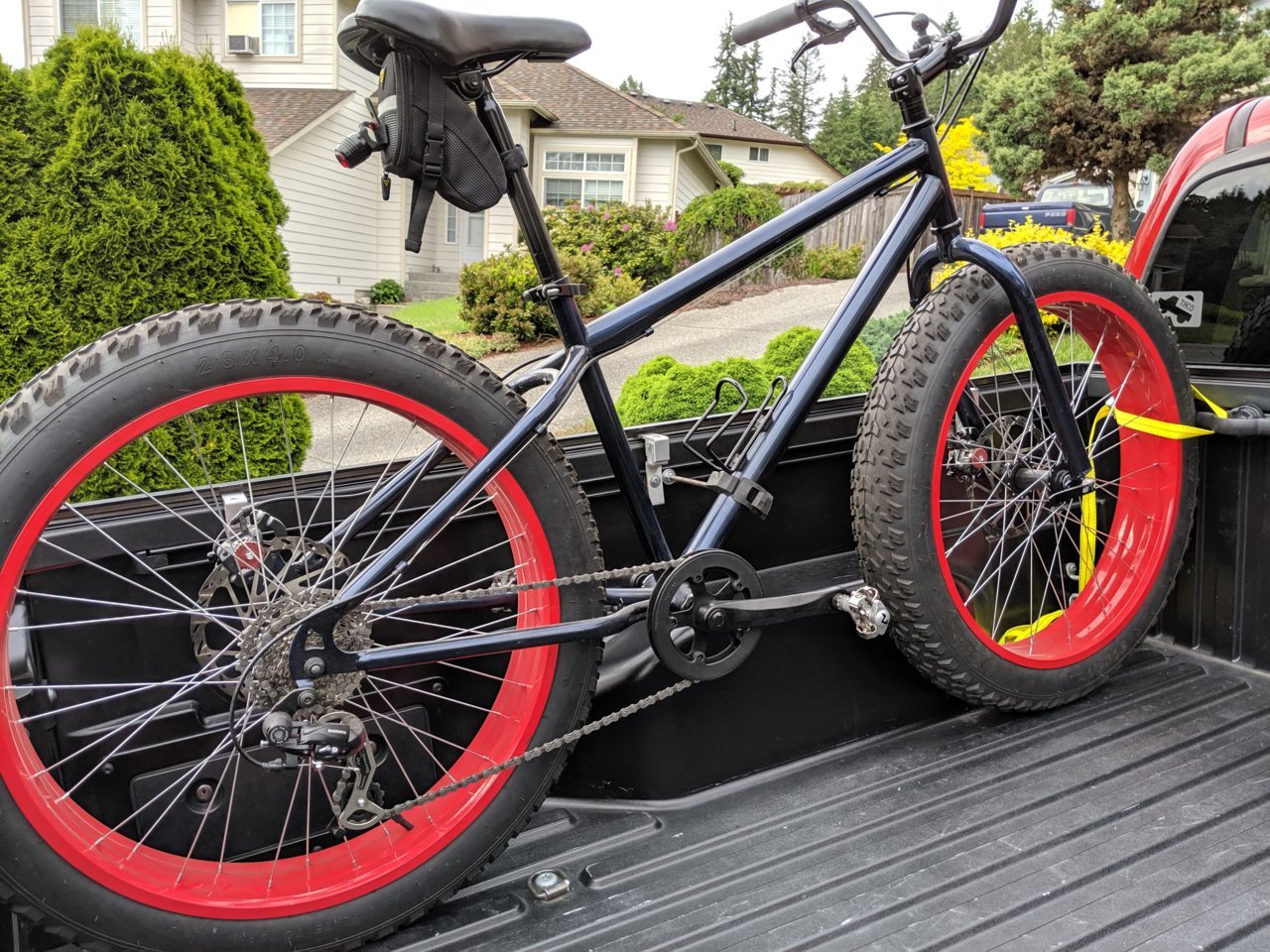

    Bike Mount.jpg You need the back accessory rail. Easy install.

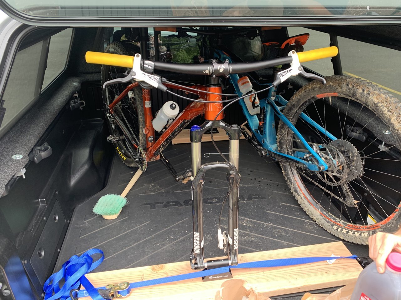

    If you want to put the axle mount at bed floor level, bolt it to a pine 2/12. It won't go anywhere.

    Couldn't somebody just walk off with the bike along with the piece of wood that the bike mount is attached to?

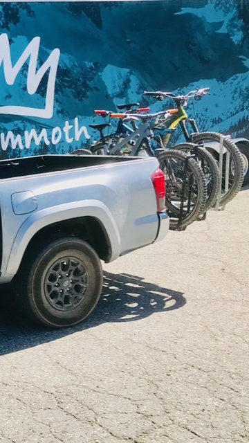

    Seems to me a rack that simply mounts into your hitch receiver would be the way to go as opposed to installing something into your bed or bed rail.

    I even had a hitch on my mazda just for bike racks. Hitch mount is the way to go :) No fuss of taking wheels on and off, height requirements on a roof rack, pain in the butt to take them off the roof, etc. And they're cheaper (than roof racks for the mazda at least, bed mounts are probably cheaper).
    It may cover the backup camera though.

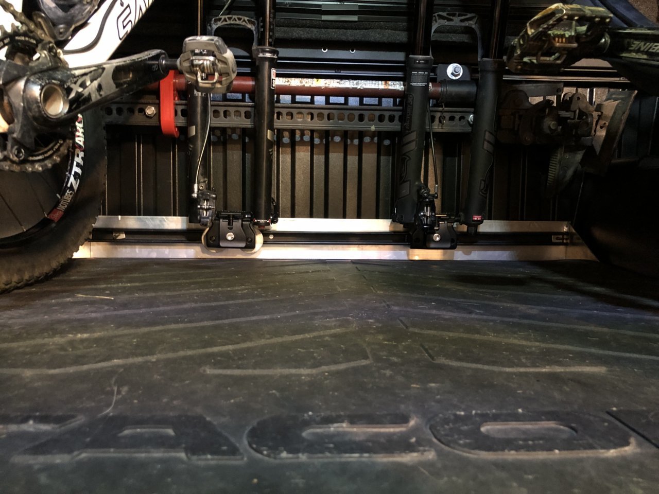

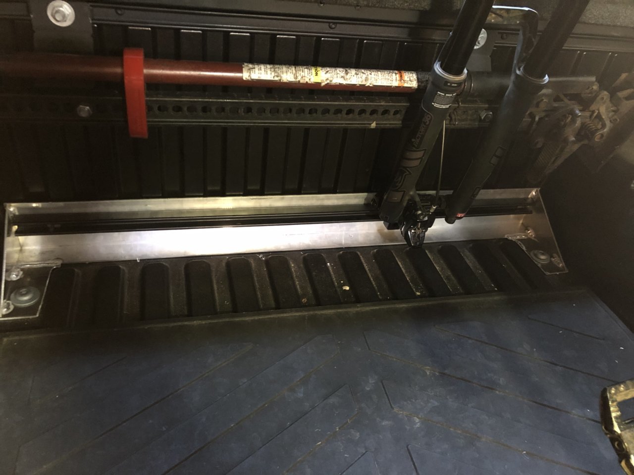

    Mine was linked above. It’s aluminum L channel extended and gusseted to reach the factor bed mounting holes. I used security hardware to bolt the OEM rail to the L channel. Then add spacers between the rail and one of the mounts to mitigate some handle bar interference.
    It’s not the quickest to stow but the bike is locked to the rail in side my locked camper shell and locked tail gate.
    Big bikes with a short bed is a tough fit. Tallboy is no prob. Med Sentinel fits Longer Geomotron was pretty maxed out.
    I also use my oneup rack when security is less of an issue.

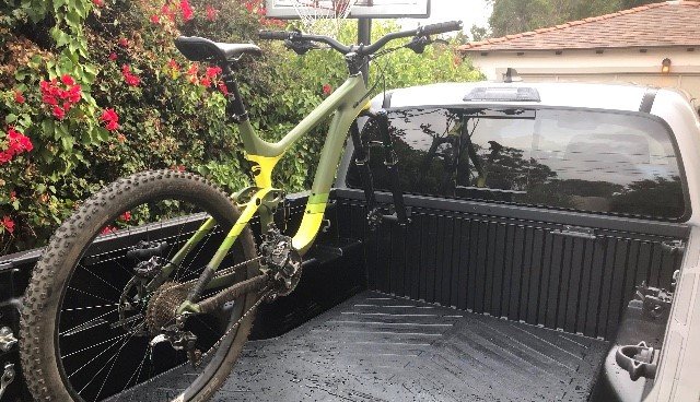

    Here is a cheap option for inside a shell
