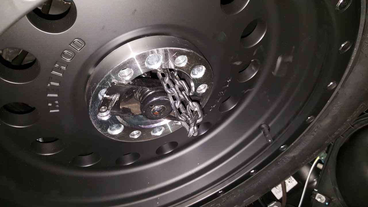

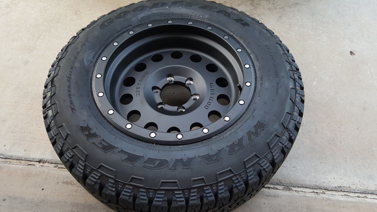

    As many have seen, for the past month I have struggled how to install the full size spare tire. Since I have replaced the OEM wheels and tires with 275/65/18 on 18x9.5 -12, I was always concerned with having a flat and not having the right spare. Long ago I did just that and blew a diff.

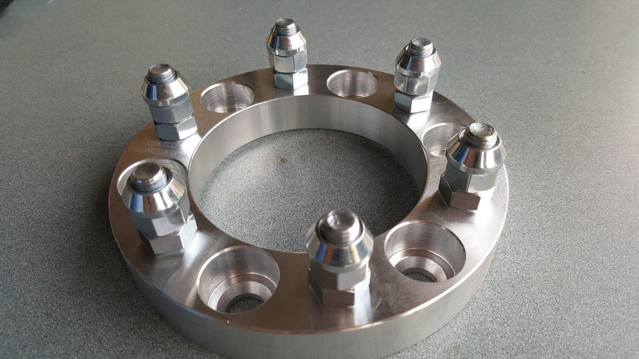

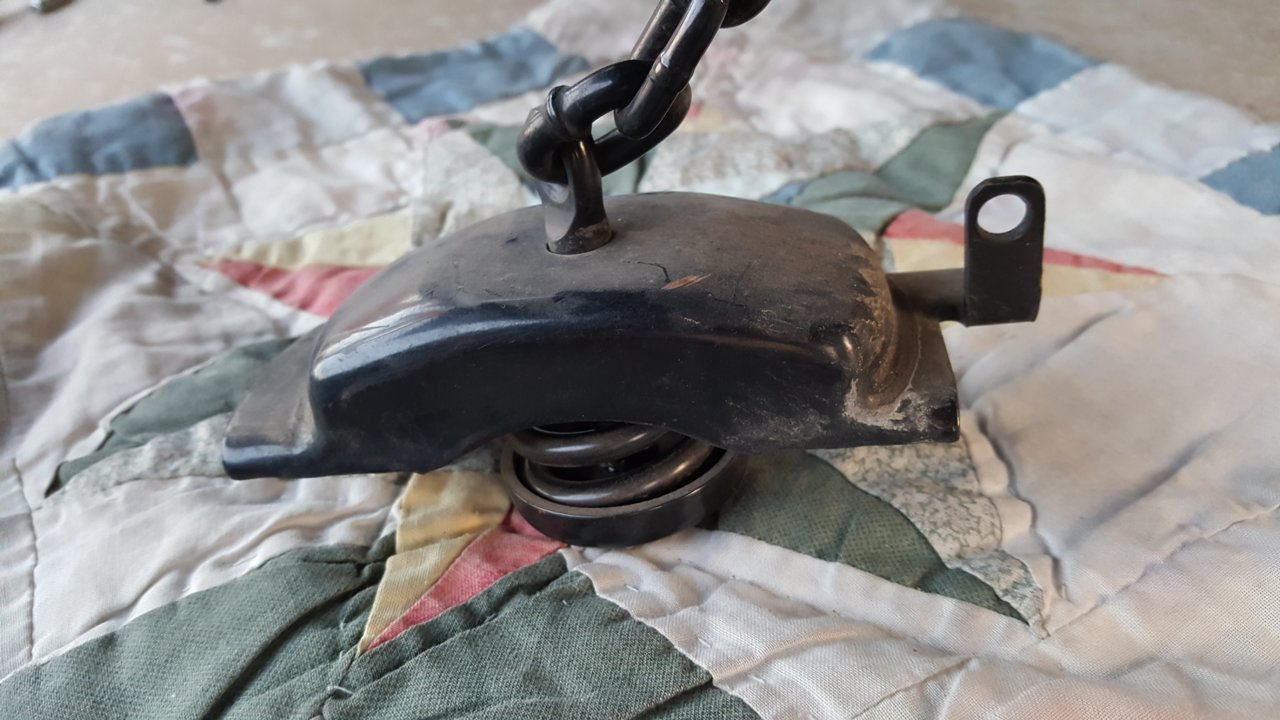

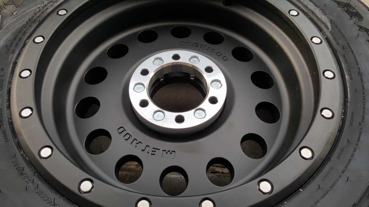

    In order to have the same tire I needed to have the same wheel...problem is the wheels have been discontinued 2 years ago and very hard to get. Since the spare tire deal was $500, I did not want to blemish the wheel. Initially I thought to install the spare in the truck bed but was price prohibitive. The other option was to install it under the truck where the OEM is located but didn't want to have it scratched by the hoisting bracket. After many questions here and different ideas, I finally installed it!!! It took a spacer, 6 nuts and a hammer to flatten the hoisting bracket claw. Done.
    I have another spacer if interested.
    Started with this.
    And did this.
    To protect this.
    I came up with this idea.
    To prevent this from scratching the face of the wheel.
    And is finally in the place.
