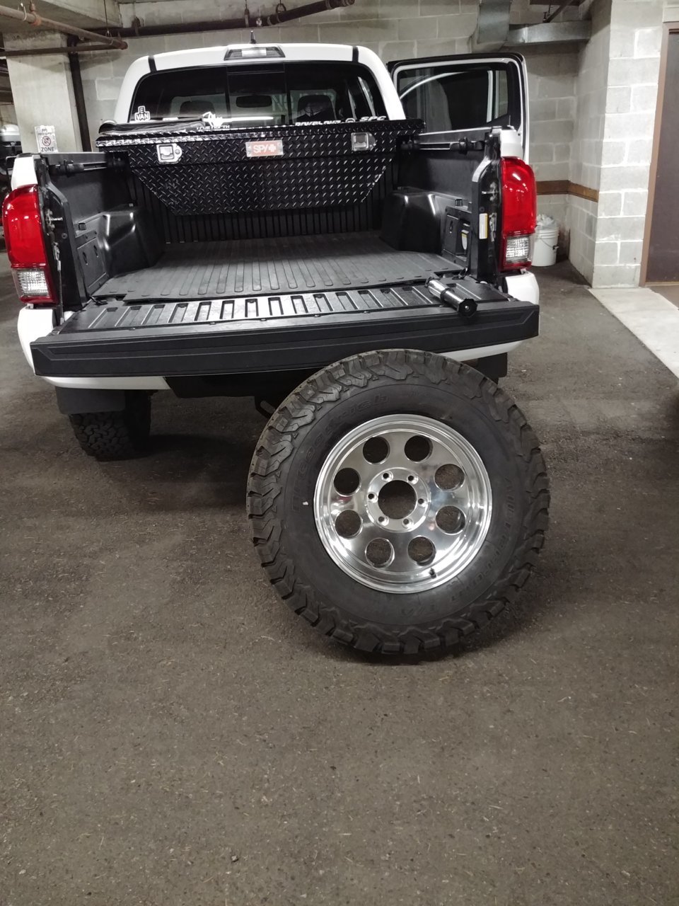

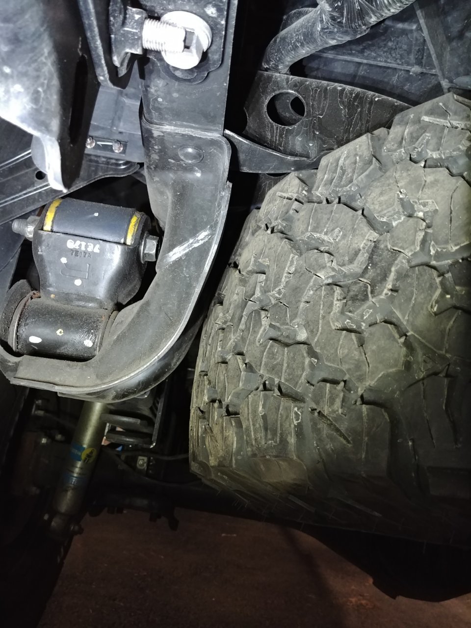

    I stuffed a k02 275/70/17 under there. I have method con 6's
    I bought a cheap rim with same offsets.
    I relocated the hoist mechanism about an inch towards the rear of the truck. When flexing it was close to rear diff.
    I also had my exhaust all rerouted.
