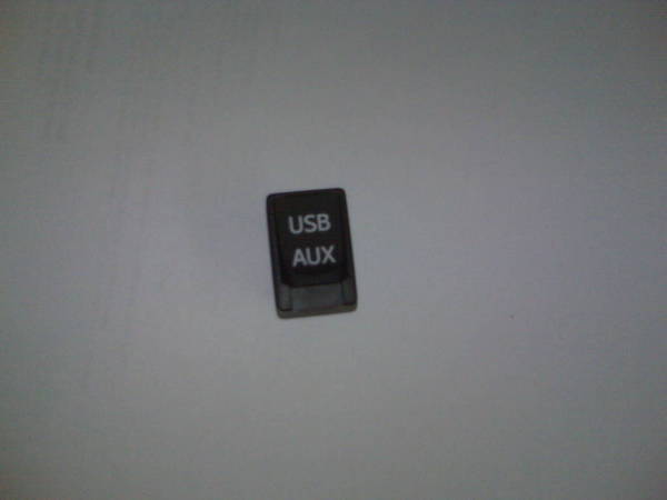

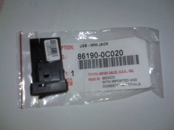

    Well guys i finally got an email back from the guy at sparks toyota. Here are the pictures
    The toyota part number is
    86190-0C020
    According to him, he said all one would have to do is install a usb cable, but the picture is kinda of fuzzy so its hard to tell. If someone could get their hands on it, that would be sweet. Sparks is 4 hours away from me so i couldn't really tell.

    Well it doesnt come with the cable and i am wondering if its part of a harness thats tied in with the other connectors. Thats why if someone was willing to get the part, we could see if it able to directly connect with a usb cable, and then cut the usb cable to tap into the power.

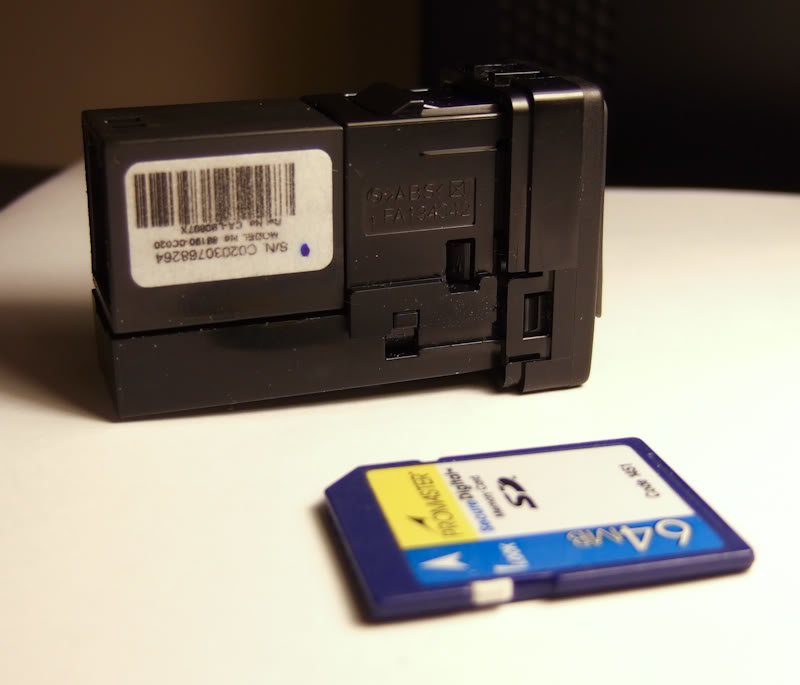

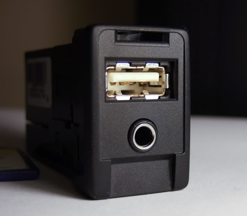

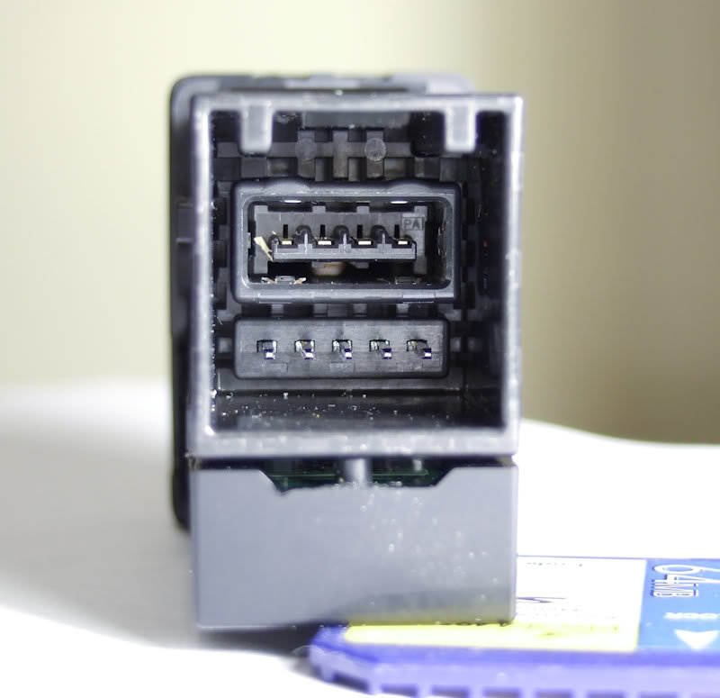

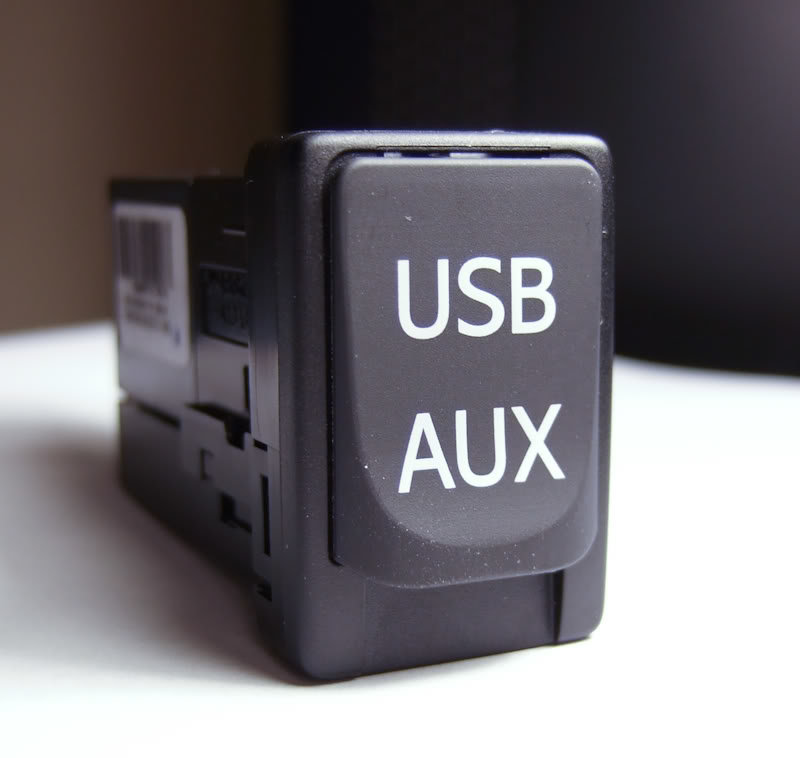

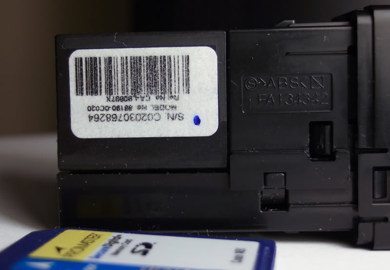

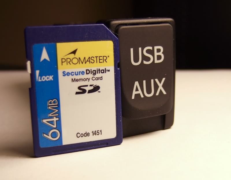

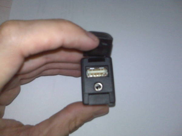

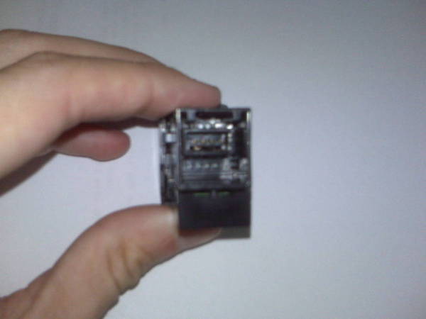

    Look what arrived yesterday!! I need to teach Sparks Toyota how to take pictures. The pictures were taken shortly after I dismantled the Tundra USB Plug and reassembled. It's pretty much what everyone expects, USB/3.5mm stereo jack. Although I did find it surprising that each connection (USB, 3.5mm) has its plug. The 'USB' looking female socket on the back of the unit, is in fact, not a USB female socket. Male USB plugs are 12mm and the plug pictures is 10mm wide on the inside. Do not fret, as I have a solution and have modified the Tundra USB Plug to accept a male USB plug. I would like to wrap up the project before I post a complete 'How To' and entertain questions. I hope to finish this weekend. In the mean time, let me know if you have any questions. Enjoy!

    Hey everyone honestly there's a super simple way to get the usb in the black insert.
    The backside has a long rectangle sized rod coming out of it with a cross support inside, if you match up a usb plug it is the same exact size.
    Then what you have to do is trace it on the front. Cut the front out, and then go into the back and cut the supports out.
    A small round file was very handy, and I imagine one with a straight edge would make it even cleaner. Only hollow it out enough for the usb plug to fit super tight.
    Put a little super glue on the usb cord and jam it in until its flush with the front.
