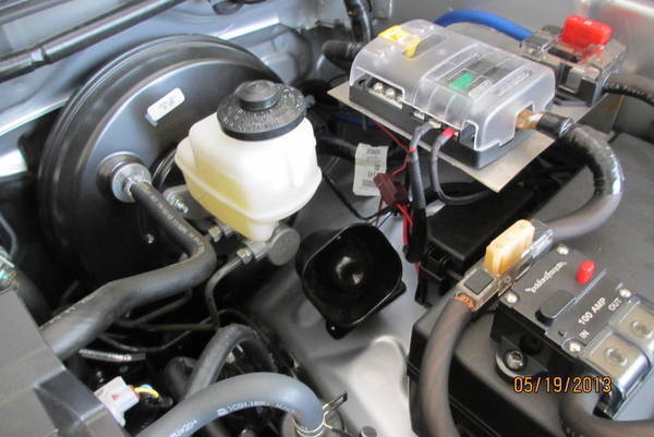

    Installed now for about 2 weeks with no problems to report. I have used remote start to many times to count with-out any issues so far. I am happy with the system. (Python 574) This guy here in Mesquite, TX did a great job for 175.

    Retrax Tonneau Cover Fox 2.5 Coilovers F/B JVC system with amp Power Block for external lights. PoP N Lock (electric) Python Alarm w/Remote Start
