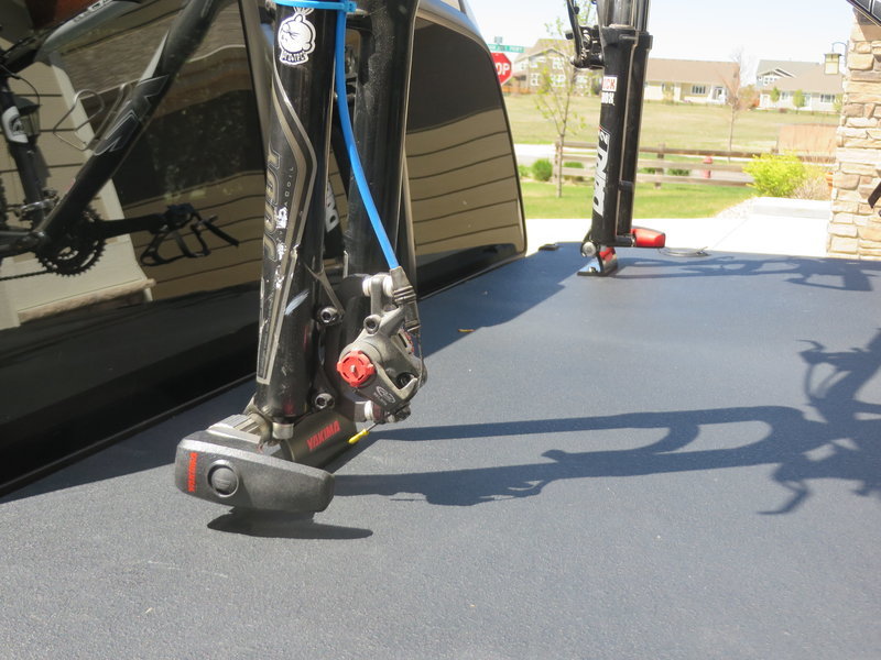

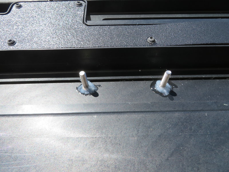

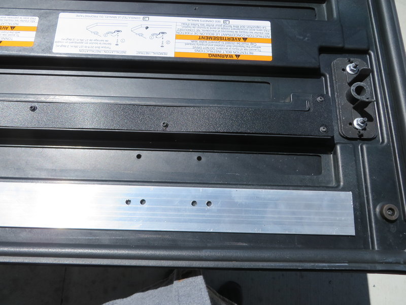

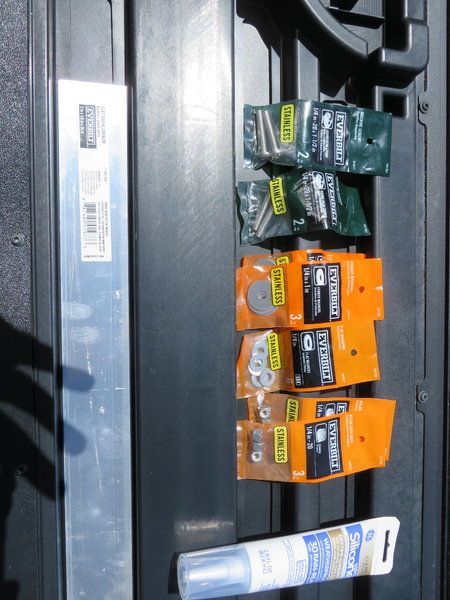

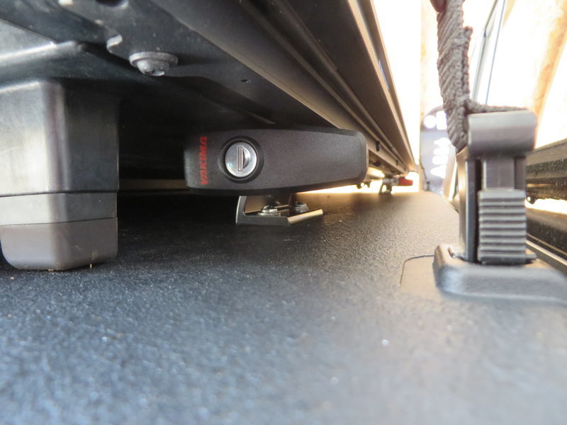

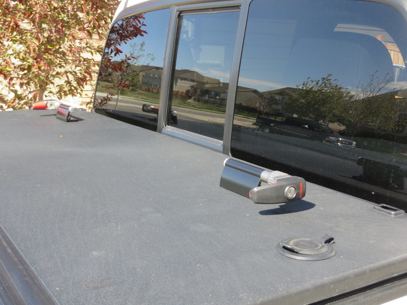

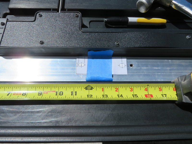

    After testing Thule, Rocky Mounts and Yakima. Only one fit the height requirement to enable the tri-fold to close. The Yakima blockhead is the one and it happens to be on sale for only $34 each right now.
    All in all the project cost around $100 for 2 bike mounts.
    Currently I am using velcro and gravity to hold the back wheels. But, I plan on mounting some small D-rings when they arrive.

    Nice idea. I want to do that but hesitant to drill into my tonneau

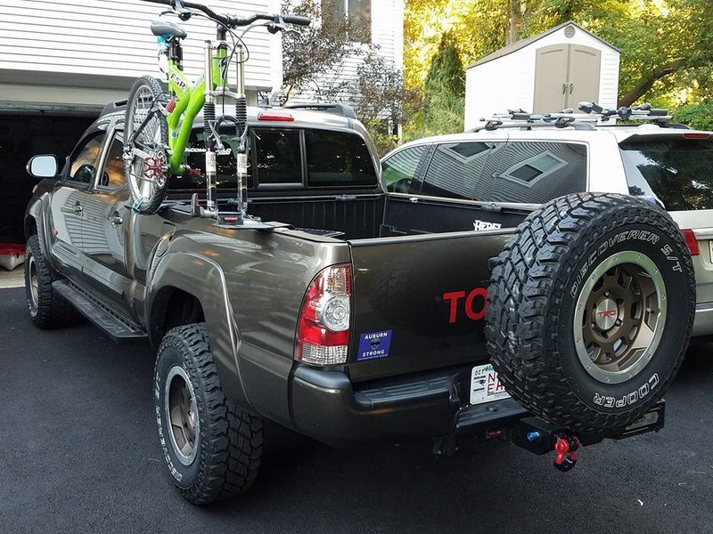

    I went with the KB VooDoo Outboard Bike Mount myself14199179_10207155458672524_605388982743552541_n.jpg

    He stopped making those

    Unfortunately yes. Love mine.

    Hey OP - why didn't you want to fold the cover forward snap the cover down and put the bike mounts on the btm of the tri-fold cover?? Curious as I'm thinking of how to do the same or similar.

    That would work but then you loose the bed security with the closed cover.
    Also you would have to reinforce the top side like I did on the bottom which might look strange when it's closed.
    If you want to mount the bike with the cover open I would suggest just removing the cover and attaching a bike mount to the head rail system underneath.
