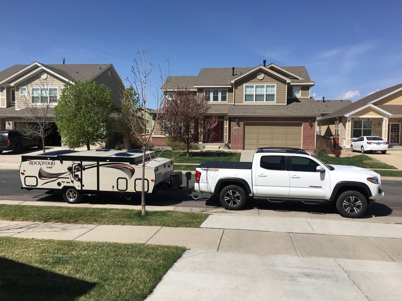

    I have the same trailer , haven't towed it since getting the Tacoma, how well does it work? I bought sumosprings but still need to get a brake controller in it.

    Tows like its not there. I installed a P3 controller.

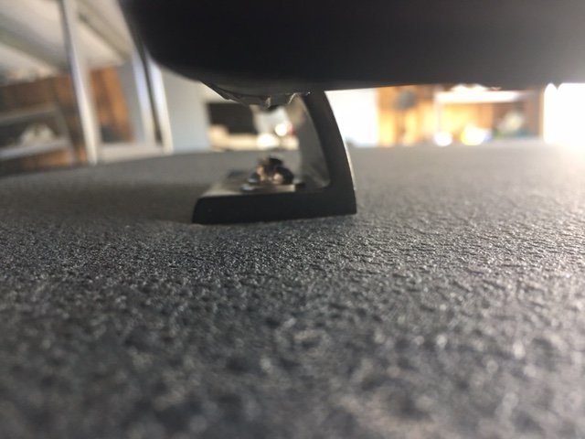

    question......when you drilled through the tonneau, is there dead space between the layers? When you tightened down the bolts, did the tonneau want to "squish" flat in those spots?

    There is a very slight bow.

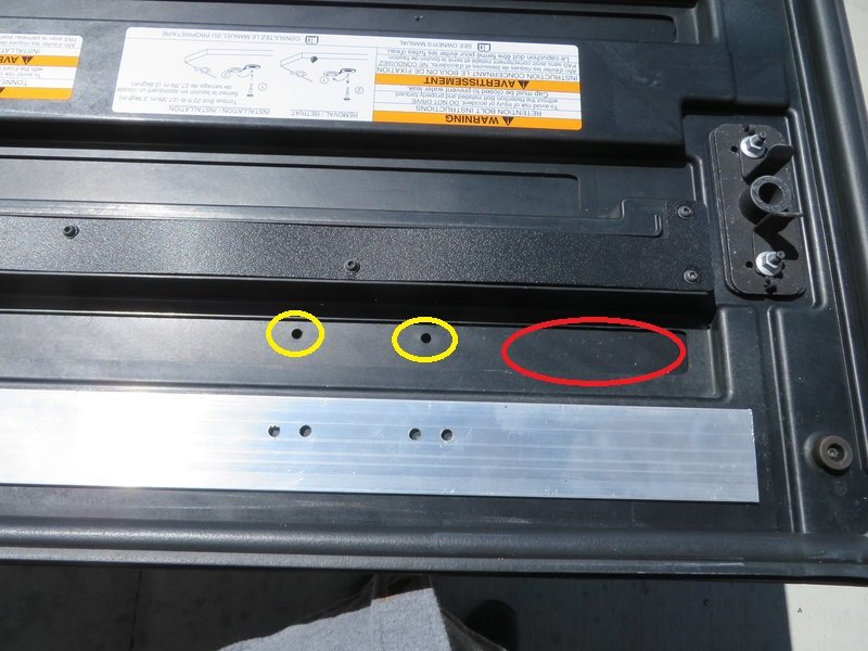

    Thanks for the pics. If there are two layers you drill through, about how much dead space is between them would you say? Just trying to learn from your experience as much as I can before I go drilling holes. Lol
  14. Jul 6, 2017 at 9:24 AM
    #34
    EGBTER
    EGBTER [OP] Well-Known Member
    Mar 23, 2017
    #214179
    294
    Wayne
    Denver CO
    2016 TRD SPORT
    You only drill through one layer (yellow). The dead space is the red area. I guess you could put some washers between the aluminum bar and the plastic to fill the gap.

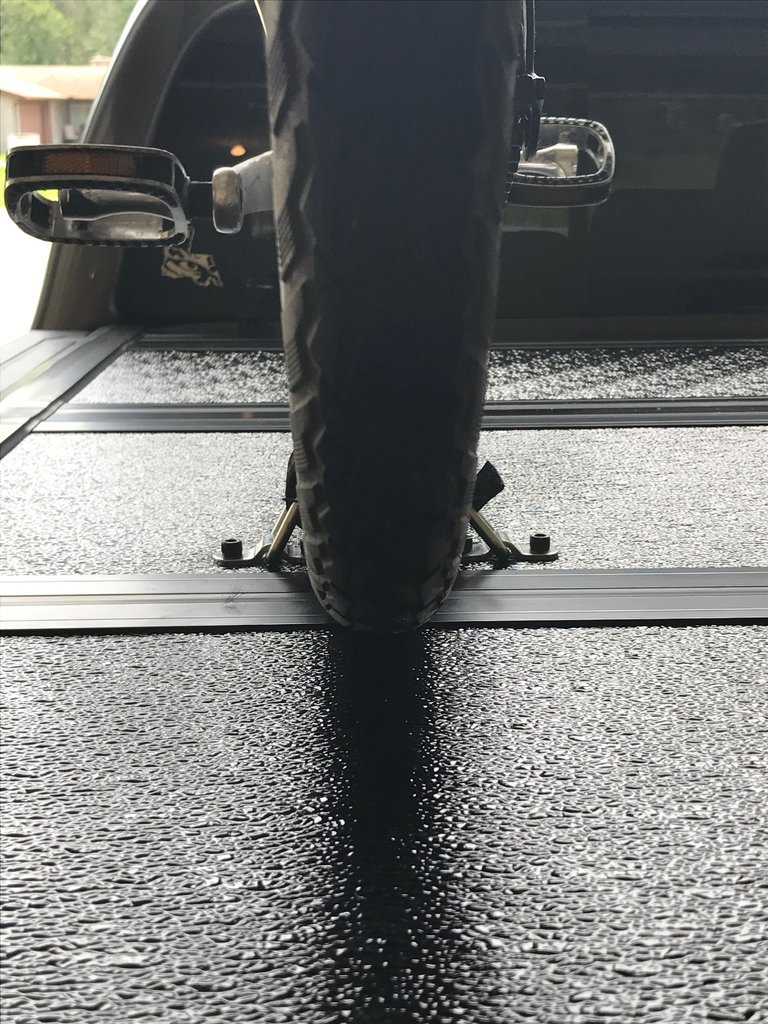

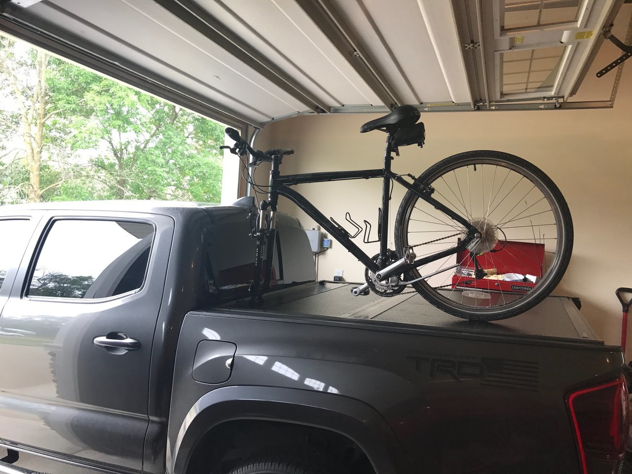

    My set up is working fine. Drove it down from Michigan to Missouri with no problems. No sagging to date. I did upgrade by putting a metal bar on top and bottom similar to the OP to provide some sturdiness on the rear.

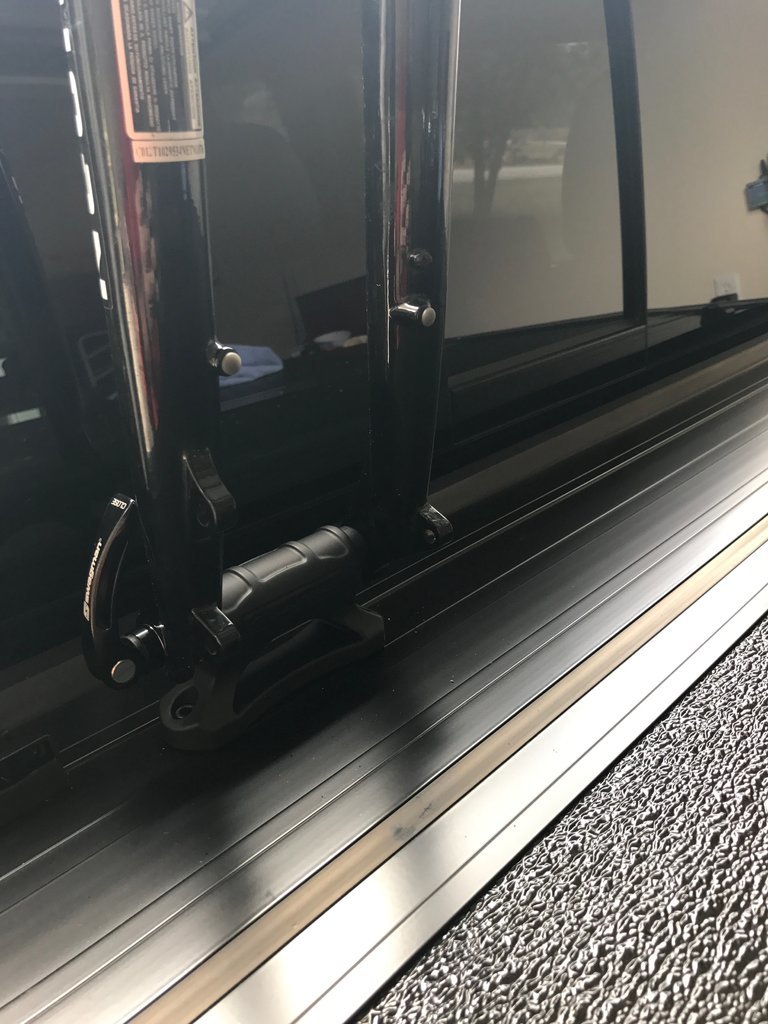

    2 Gallon Airtank with Firestone AirRites
    I use Thule bars with a 2x4 with I u bolts to attach it to one of the bars. I then use eye bolts with a bolt going through them to hold the front forks. I will have to find some better pictures.

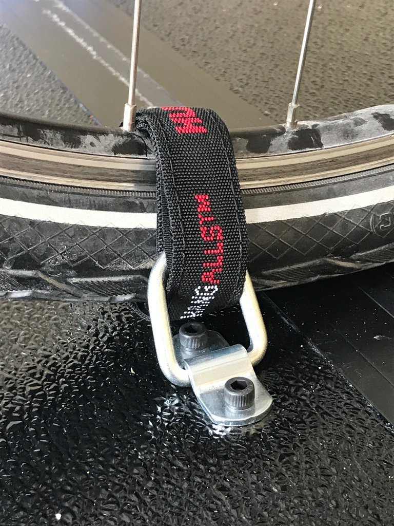

    what kind of strap is that you used for the back tire?
