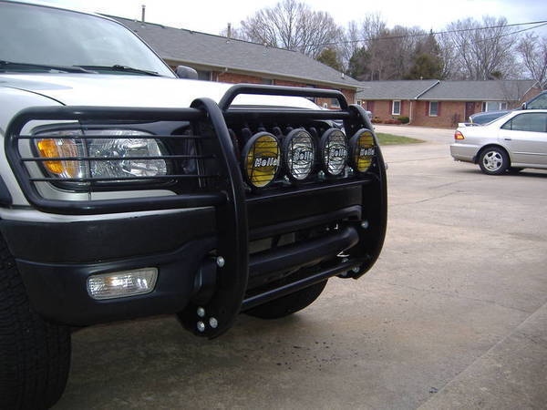

    the 2 big brackets go on the bottom where the tow hooks are....reuse tow hooks and bolts. the smaller brackets go in the bumper inner corners....thru the aluminum bumper mounts. then...mount the brush guard and level it.
    you can kinda see the smaller bracket in the corner there....
