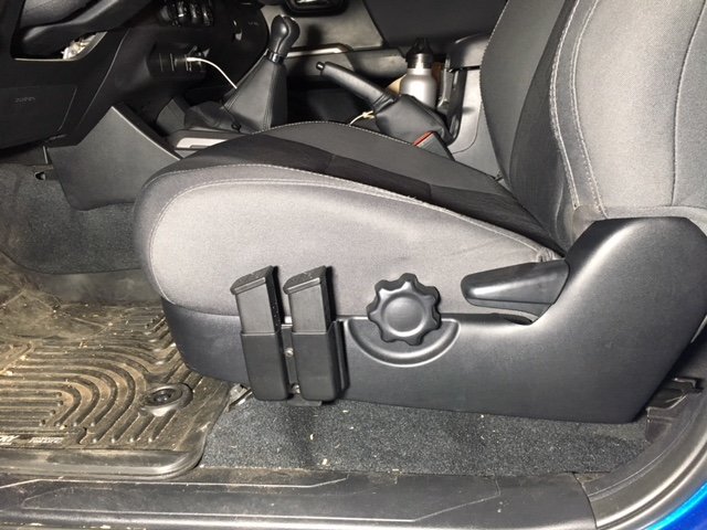

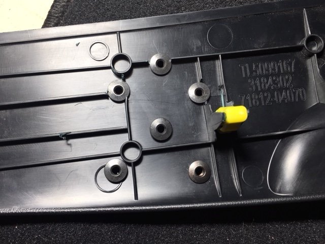

    I installed a double-mag pouch today on the left side of the driver seat of my 3rd Gen MT. I used a Blade-Tech Mini-TMMS (Tactical Modular Mount System). This could be used to mount just about anything and it's quickly removable with its sliding locking mechanism. This may or may not apply to all generations. I was surprised how sturdy it is with two fully loaded Glock 17 mags (17 9mm rounds apiece). The only caveat I can think of is maybe my shorts catching on the magazines while exiting the vehicle. Anyhow, here's what the end result looks like:
    Steps:
    0. Before you begin: while sitting in your normal driving position, measure the position of where your magazine pouch is most comfortable for you. I recommend 0-3 degrees forward cant and leave room for your hand to adjust the lumbar knob. While it may feel more ergonomic at first, if you cant the magazine backwards in any way, your elbow is bound to hit the seat or pillar while drawing a magazine, especially under duress. Mark the plastic with sharpie or pencil.
    1. Slide seat back or forth for better accessibility.

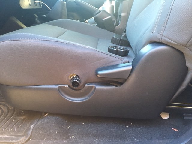

    2. Pull off the lumbar knob. It just slides right off with a good pull.

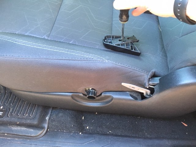

    3. I removed the plastic recliner lever, but I am pretty sure I didn't need to, so you can skip this step.

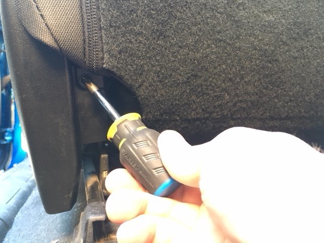

    4. Go in the back seat and remove the small Philips-head screw on the lower left rear of the driver seat. It helps to tilt the driver seat all the way forward to bring the screw into view.
    5. While in the back seat, pull the plastic off the mount where the screw was located.

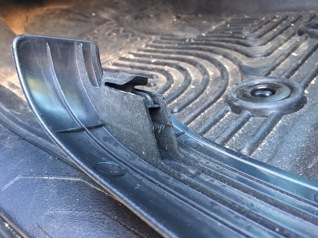

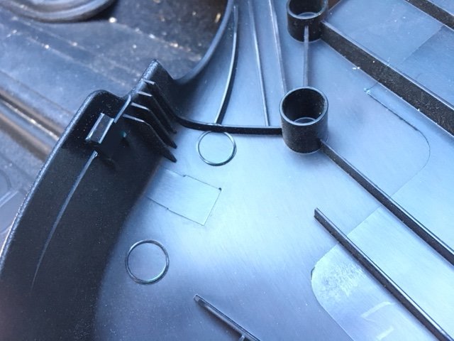

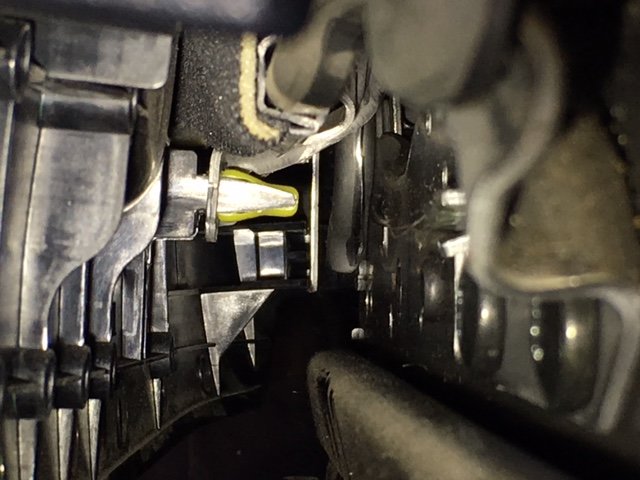

    6. Go up to the driver seat and use a screwdriver to help pry the invisible little clip holding the top round plastic section to the seat. ****This photo shows the little clip AFTER the plastic piece is already off.**** Since it's invisible, I thought this would help y'all get the concept of where to pry. You can definitely get away with just yanking but it will weaken this clip.
    7. Now reach under the plastic to feel for the yellow clip in the middle of the plastic piece. Pry the plastic gently toward you until the yellow clip pops off. Here is what that yellow clip looks like before you remove...
    8. Slide the entire plastic piece forward toward the front of the vehicle and remove.
    This is what the slide clamp looks like so you know why you must slide the plastic piece forward

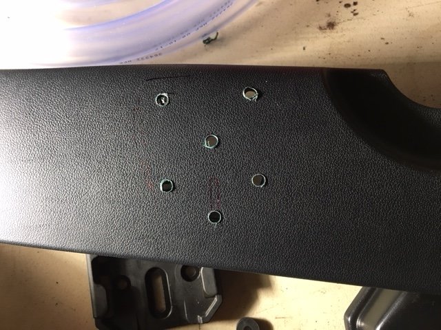

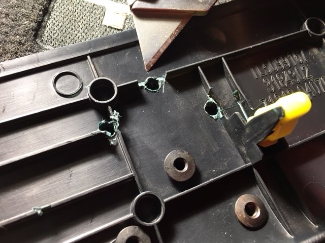

    9. Mark and drill the holes.
    10. Trim any vanes as necessary with a razor knife to leave room for the Chicago nuts.

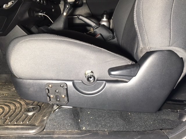

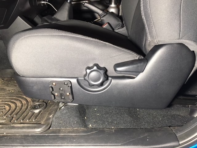

    11. Attach the female mounting plate using the Chicago screws and reinstall everything in reverse order. Here it is with the mounting plate installed. I used a rubber washer on the upper right screw between the mounting plate and plastic in order to prevent the top curved area of plastic from bending to fit the mounting plate.

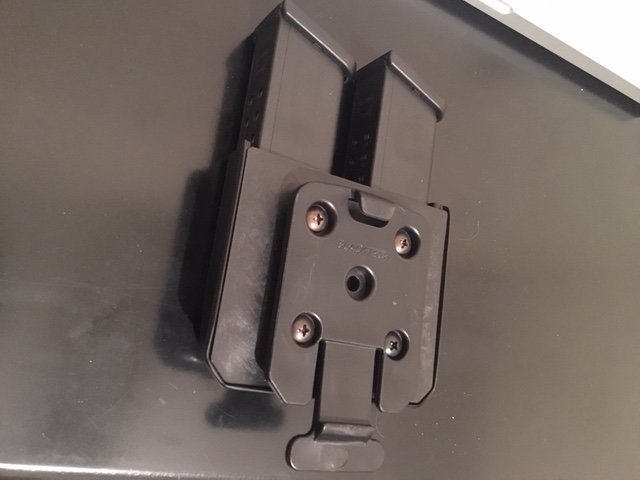

    12. Mount the male end of the Blade-Tech TMMS to the mag pouch. I used a Blade-Tech Signature Mag Pouch since it lines up already with the TMMS, but you could retrofit any brand of thermoplastic mag pouch (Kydex, Boltaron, etc.).
    13. Slide the male end into the female mounting plate until an audible click is heard. You can now brag to all your friends that you keep dirty magazines in your truck, and when they scoff you can show them and say "Here are my dirty magazines. What were YOU talking about???" ;-)
