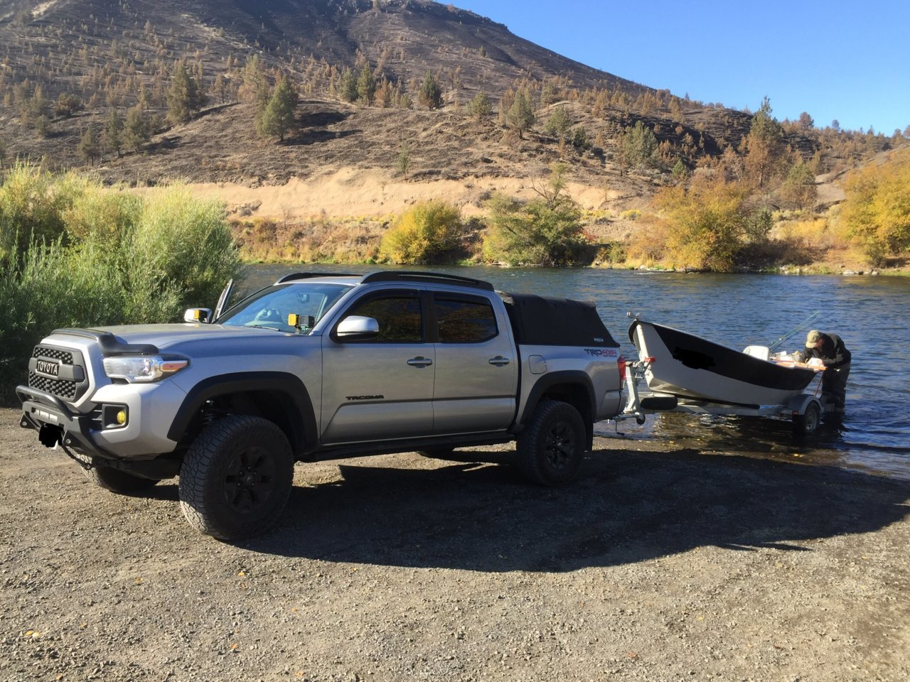

    It’s not that I didn’t agree with some of the things he was saying either. OP just asked in his first post about the sag and so I just offered two options. I personally have DSC with custom leaf pack from ArchiveGarage and I absolutely love my setup. My cousin wanted me to go with the airbags so bad because he has theM on his truck but I figured I’d save that for my trailer :)

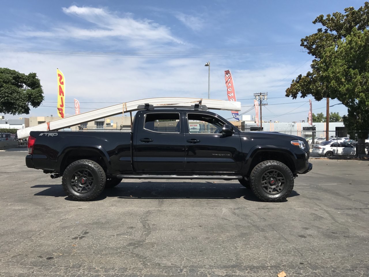

    Tundra Sumo springs and fully loaded bed.
    There's boxes of hardwood flooring in the bed with all those moldings on top.

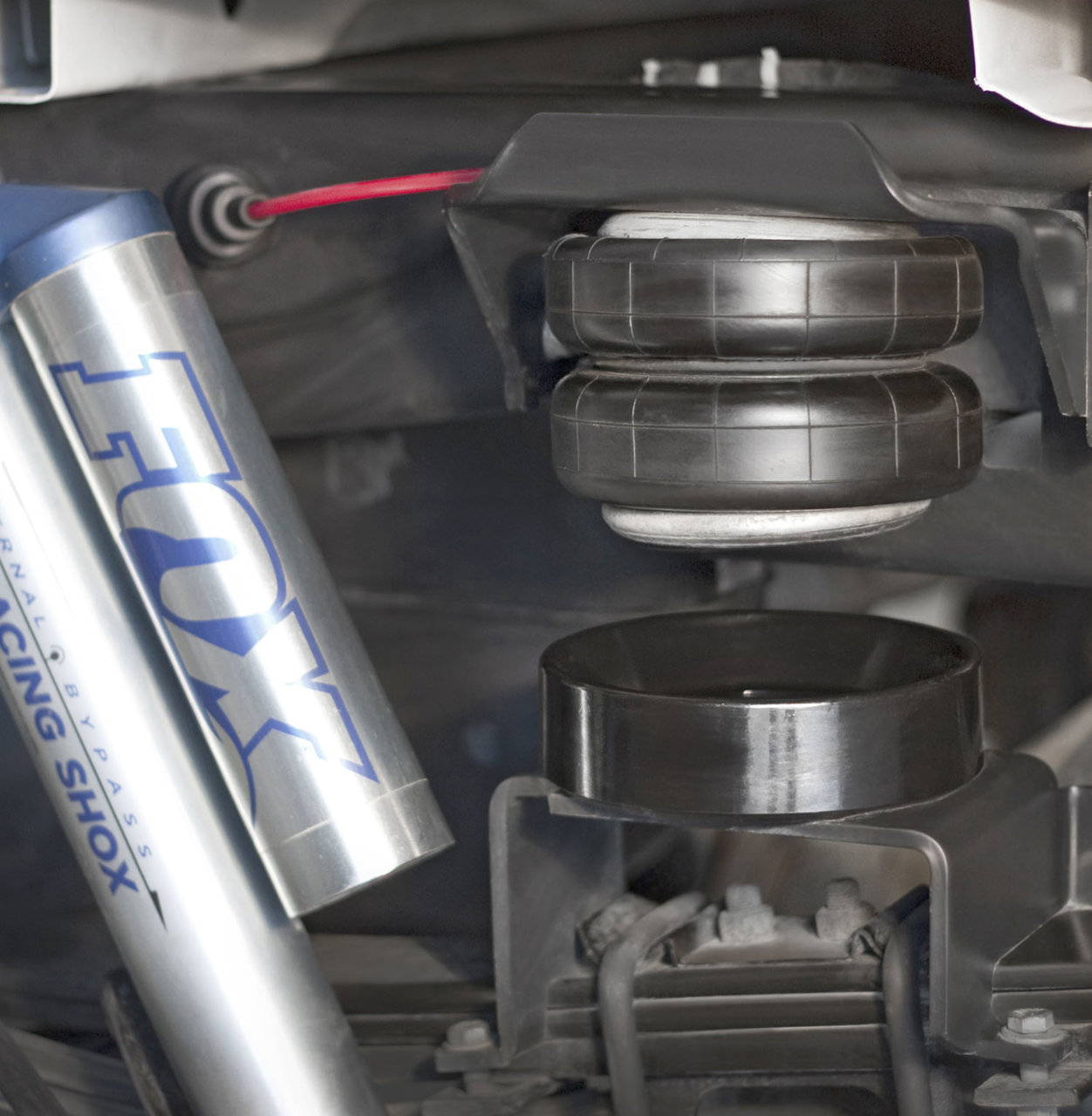

    Airbags with a cup setup so it doesn’t affect the ride. Ps not my truck (Google image)
    You could also get a Dakar pack and keep your stock suspension. The leafs are the weakest POS on these trucks. The Dakars are sweet for towing just don’t get the HD pack unless you are constantly carrying 600+lbs
    ...been there done that. Took a leaf out now at 6 leafs and it’s awesome to pull the boat

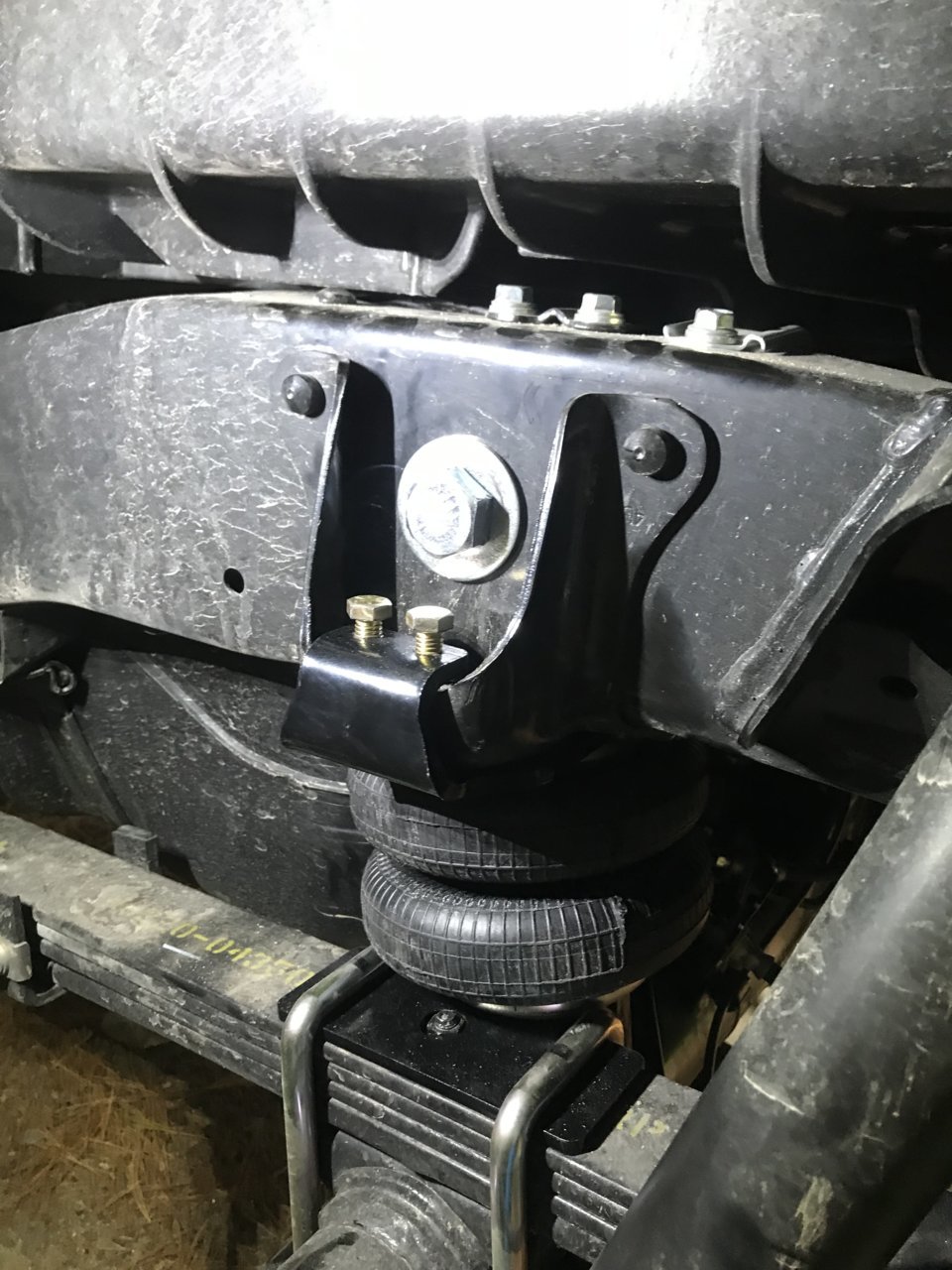

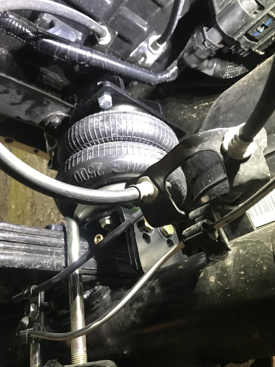

    9112367F-08E6-41C8-9917-2E699D0C3BC8.jpg 543F2163-0C0D-4F58-B8CB-CCE60052E15B.jpg
    I like the cup idea. I ran the firestone airbags without a cup for 10 years without a problem in my 09 Tacoma. Never did any serious off-roading with it. Always had about 600 to 700lbs in the truck between tools and a camper top. The truck always rode level with about 20lbs of air in each airbag. I just installed Helwig airbags in my new 2018 double cab Tacoma. I noticed the airline comes off the bottom of the bag with the Helwig setup where the Firestone bags had the fitting at the top. Coming off the top the line will be stationary. I hope this doesn’t cause a leak in the line on the Helwig setup with the suspension traveling up and down. Time will tell.The line wasn’t installed yet when I took the picture. You can see the brass fitting for the air line in the top picture next to the leaf spring.
