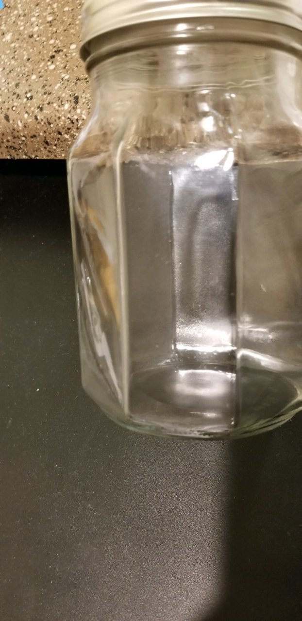

    The real benefit of nitrogen is that it is dry: The amount of water vapor that air can hold is dependent upon temperature and pressure.
    If you fill up your tires when it is 90 degrees with 90% humidity, there is a lot of water in the air that you have now trapped inside your tires.
    When the temperature cools to 60 degrees, the air cannot hold that much water vapor, and it condensates out to a liquid (inside your tire). As liquid water takes much less volume than water vapor, the pressure decreases. Which again, decreases the amount of water that the air can hold. So you get even more condensation.
    So if you are going from cool mornings to hot days to cool evenings, your tire pressure is going to vary by quite a bit throughout the day. It will not be noticeable at extended highway speeds when your tires heat up.
    But during slow or intermittent driving, your tire pressure will be all over the map as the tires heat and cool from driving and as the air temperature varies.
    To avoid this, fill up your tires when it is cool/cold and when the humidity is low. This minimizes the amount of water that you put into your tires.
    If you do have to top off your tires on a hot, muggy day, then let out the air and refill it when it is a cool, dry day. Either that, or take it to a N2 dealer if you need air on those days.

    I took one of my moonshine jars. warmed it up in the shower with hot steamy air. Then sealed it and stuck it in the fridge.
    You can see the water condensation on the inside of the glass. This is what happens inside your tires.

    On paper you are correct and not every shop bleeds their compressors daily, but in the real world with car and light truck tires it will not make one bit of difference. Respects...but if paying for "dry nitrogen" makes you feel good...do it.

    Except you are not blowing warm humid air into your tires by mouth. When air is compressed, the moisture drops out of it. The amount of moisture air can hold is dependant on the temperature and pressure. As the temperature drops it holds less, hence condensation. As the pressure it goes up it holds less. That is why compressors need to be drained of condensate periodically or they rust. So the air you are getting from an air compressor is not nearly as humid as the outside air. Blow some air into your shine jar from a compressed air tank and see how much condensate you get.
