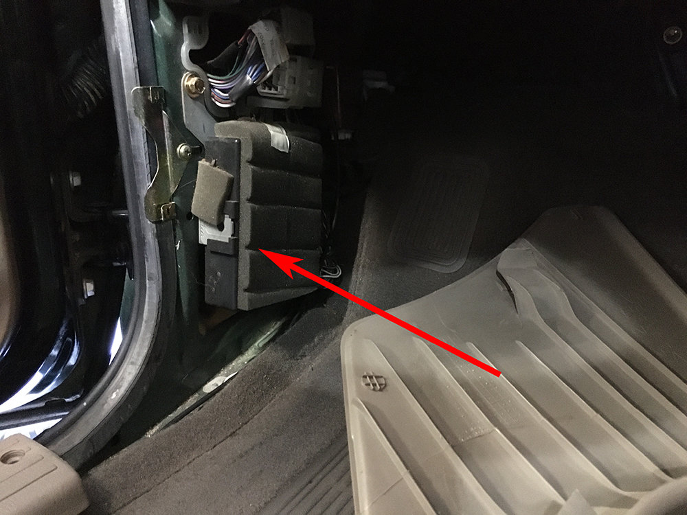

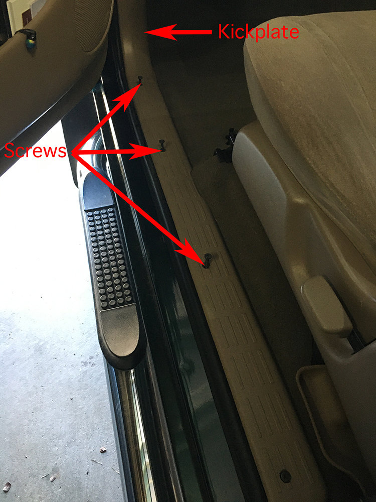

    1. Check to see if you have the RS3200 (receiver) already.
    (From what I gather, this was installed on a lot of Tacoma's in anticipation of the owner requesting the keyless entry upgrade. The unit doesn't even appear as being present in my truck when Tacoma looked up my Taco by the VIN number. But it was there! He said it may have been something unique to southeastern sold Tacos, but who knows)
    a. Take out two-three screws from the baseboard to relieve tension on the kickplate.
    b. Remove kickplate.
    c. Look to see if you have the square box thing pictured (RS3200)
    d. If you have it you're golden! Put everything back.

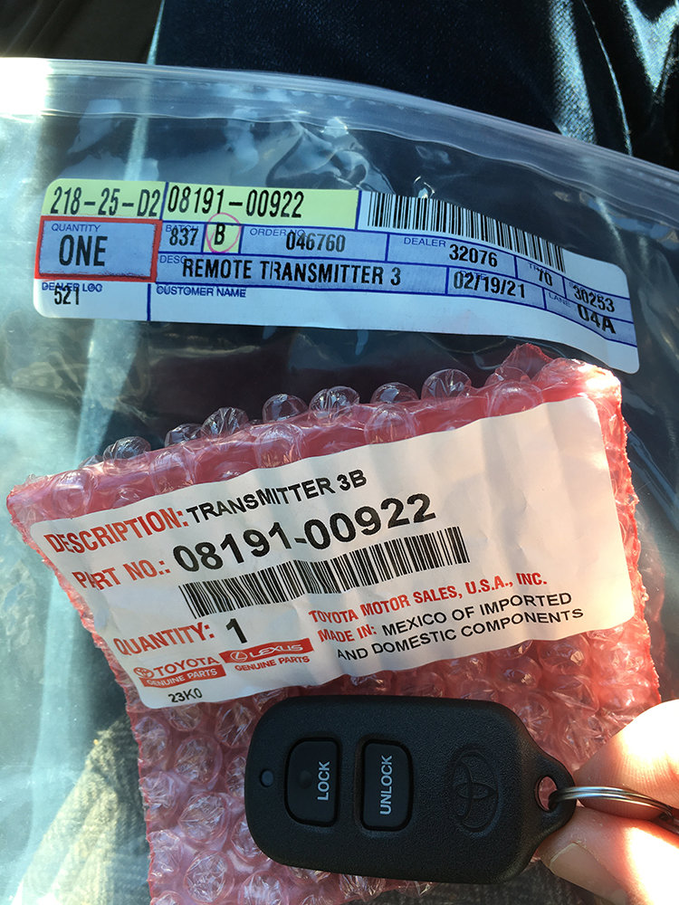

    2. Get a key fob
    a. Get it at your local dealer like I did. It was $57. Ask for part #08191-00922
    b. Or get a third party one. This should work, but is not how I went. This is the $25 one I was considering: Third Party Key Fob on Amazon
