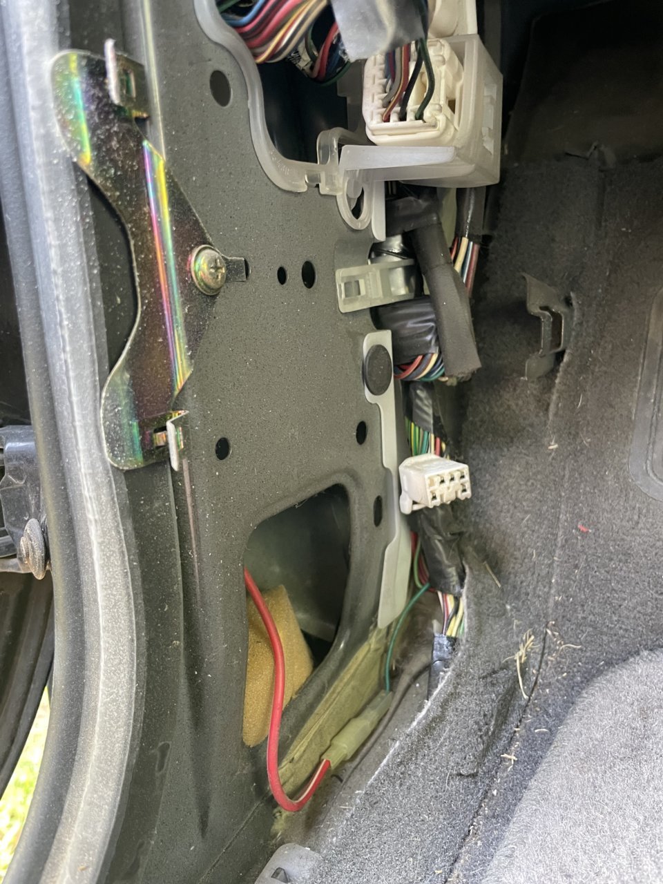

    I just picked up a 2001 Tacoma PreRunner Xtracab Stepside and checked to see if I had the RS3200 receiver but unfortunately I do not. Can I buy one and have it be plug-n-play with the white connector seen in my photo?

    I've run into the same issue. That plug IS for the missing module (probably just the power source, speculating) but it's not the only plug we need. There is a separate wiring harness coming off the back of the module that connects between various different plugs. The part number for that missing wiring harness we need is 297140-42800700 (82132-YY050). Seems hard to find outside of going to a junkyard ourselves.
