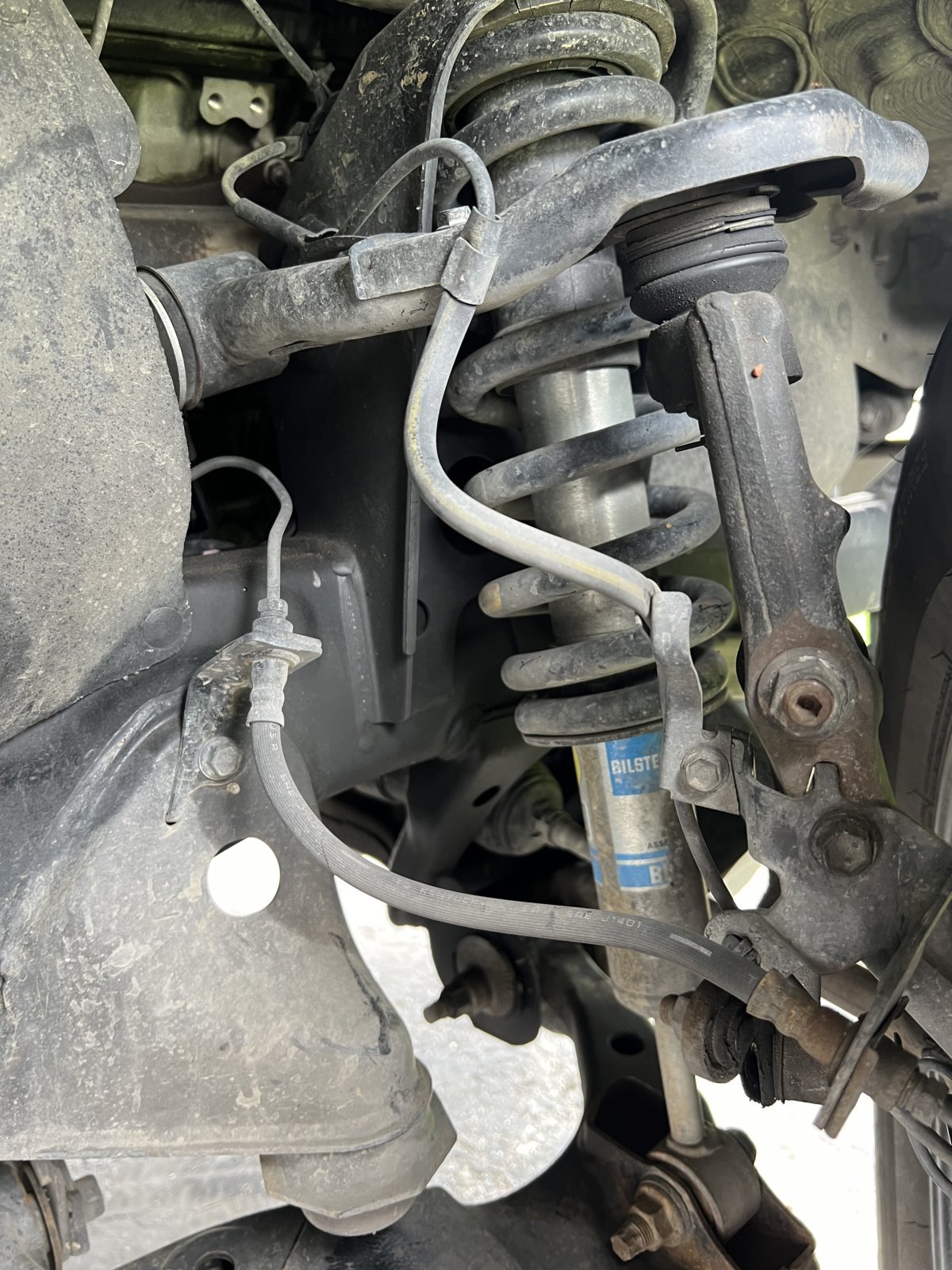

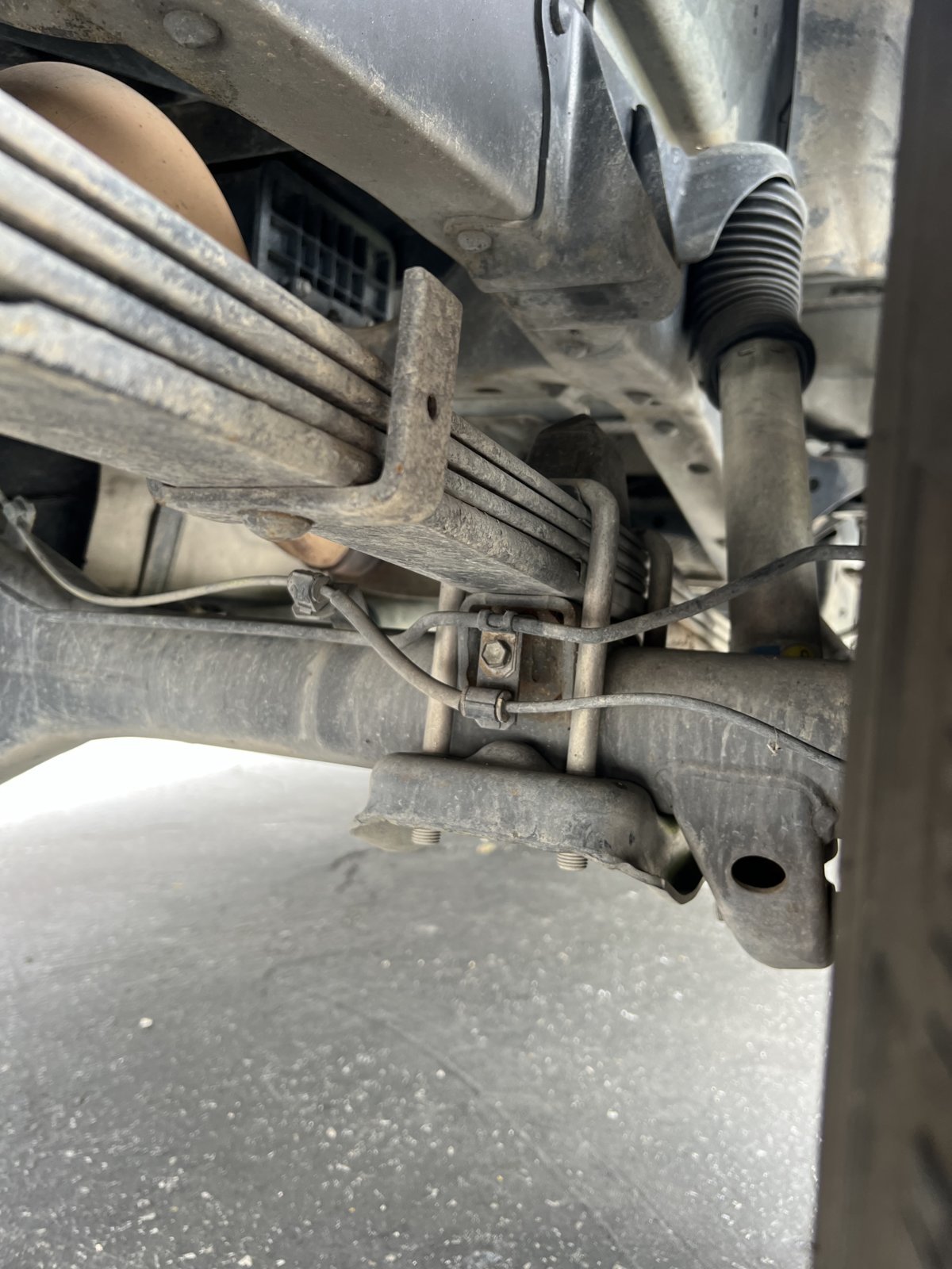

    I bought a used 2006 prerunner v6 4.0L 6 lug and want to swap out the suspension because it’s all squeaky. Now the tires it has are 265/70/17 and I think factory it’s 265/75/16 (correct me if I’m wrong). I just want to know if there’s any way I can tell if it still has its stock lift or if any lift kits were done/added to it. Not very familiar with suspension work so if I’m missing information that’ll help please let me know :) Thanks in advance!

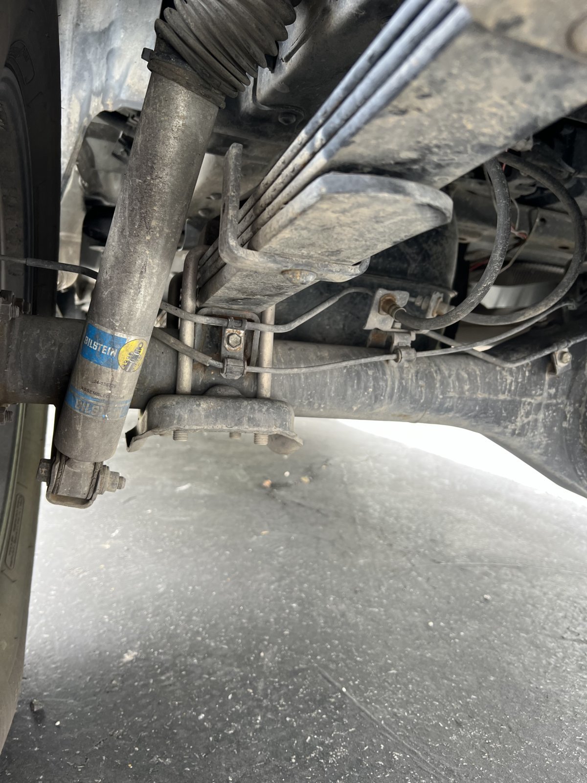

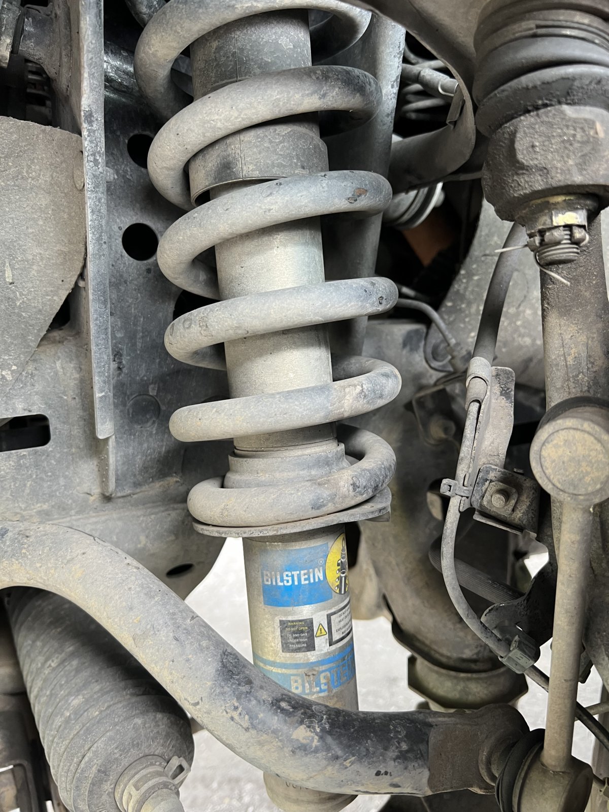

    Bilstein 5100s all the way around. Looks like the fronts have factory springs on the zero setting(no lift) no lift in the rear.

    I'll guess at least part of the squeak is the leaf springs. Maybe a lot of it. Leaf springs have squeaked since their invention.
    Lots of threads around on various fixes.
    I suggest jacking at the frame so the leaves 'open up' blast with water, blow with shop air then spray between them with a lubricant. Both sides.
    30 minutes of effort will at least give a clue if this is one of your main squeak points

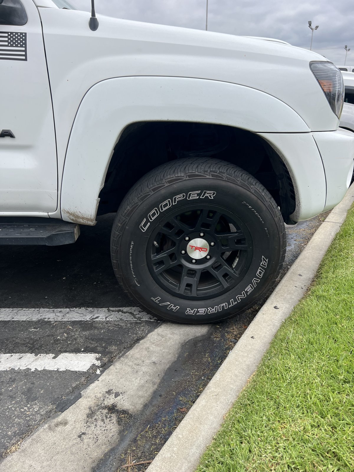

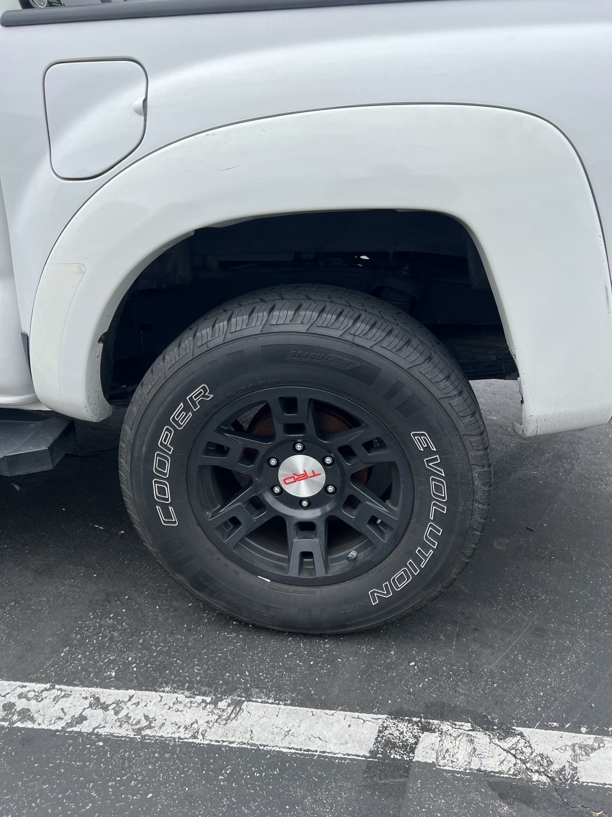

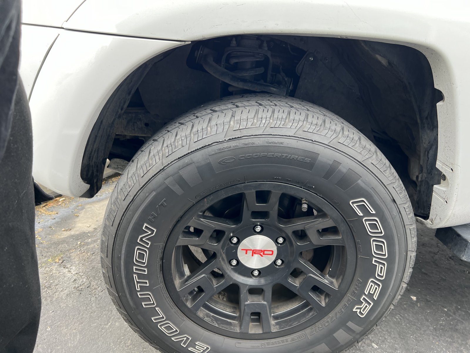

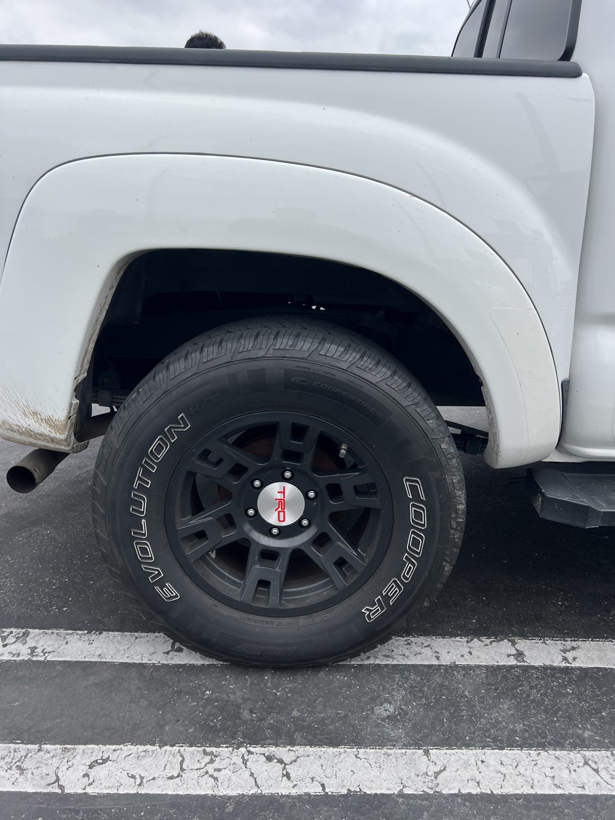

    It might be the angle or my eyes and has nothing to do with squeak but those tires don’t look right - like low profile?

    265 70 17 is what I read......

    Take a few steps back and take a pic of the whole side of the truck. It looks stock from the magnified pics...lol
