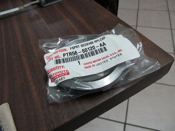

    Inspired by BeePee's write-up on flush-mount TRD center caps, I took a slightly different approach to mount Lexus GX460 F-Sport center caps on my Konig wheels:
    [​IMG] [​IMG]
    • No gluing.
    • No permanent modification to center cap.
    You will need:

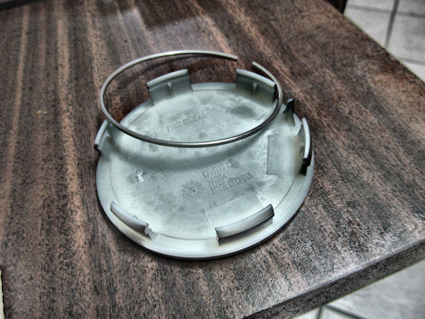

    1. Remove the wire ring from inside the center cap. Interestingly, the bag label says the part is made in the US, while the molded part-mark says made in China.

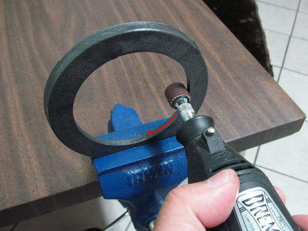

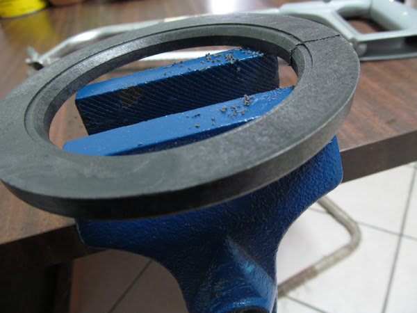

    2. Cut a slit in the hubcentric ring -> takes less than 20 sec with a hacksaw and bimetal blade.
    3. Using the Dremel, sand the inside diameter of the hubcentric ring. Move the sanding wheel in a circular motion to ensure the hole remains round. Continue until the center cap can fit while expanding the ring slightly (opening ~3 mm gap in the slit).

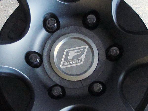

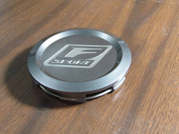

    5. Push in the center cap until it snaps into place. The center cap expands the ring like a collet, causing it to hold tightly inside the wheel bore. End result:
    I've put about 280 miles on it since installation, and it hasn't loosened.

    Looks good! I couldn't even tell it had the ring around it that first time you posted a picture. Nice job.
