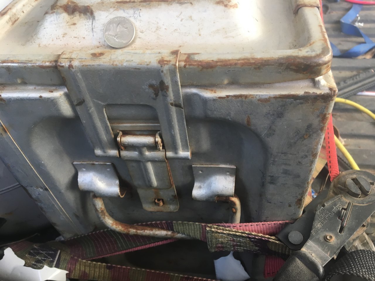

    it looks like some sort of pin goes into the latch but I don’t know more than that. Looks like the pin should be approx 1/8” diameter. See the nickel on the lid for size.3D221A6D-8A45-46BE-8CA8-5F5B65963220.jpg
    I use the box for recovery gear FYI.
    Any ideas?

    Looks like it's made for a cable.

    Zip tie that thing closed

    Would one of those .50 cal ammo can lock kits work? Only a few bucks on cheaperthandirt.com.

    That makes sense. I’ll see if I can make something out of stainless cable and use a padlock.
    Good thinking.

    From the photo it appears to have 4 clamps, one on each side, holding the lid on. If you intend to use those clamps to lock the lid, you will need to secure two opposite clamps. I think it may be simpler and far more secure to use a separate locking system.
    I would suggest bolting two flat metal bars on opposite sides of the box so that the ends of those flat bars extend beyond the top of the box. Drill a hole in the top of each of those metal flats so that a round bar can be passed through them and span the top of the box. That round bar needs a "L" or a head on one end and a hole drilled through the opposite end so that it can be secured with a pad lock.
    When the round bar is passed through both brackets and secured with a padlock, it will effectively trap the lid under it.

    Cotter pin
