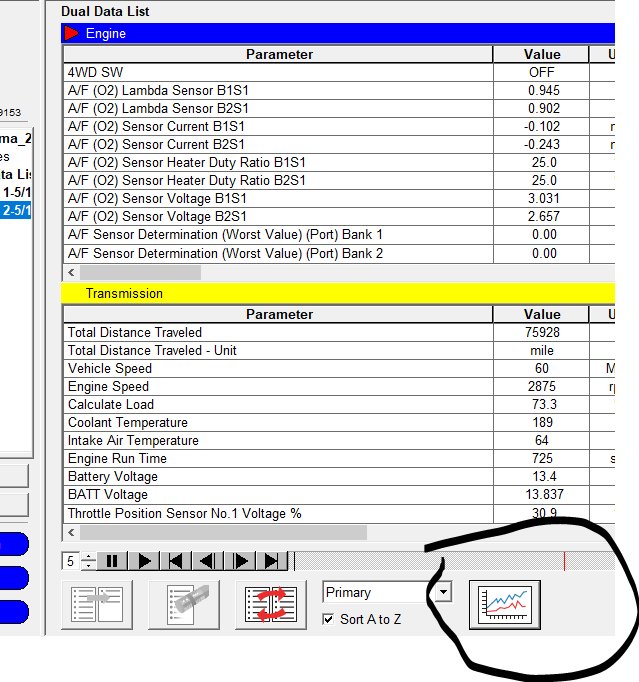

    So you have a saved event file or you are trying to graph while running the datalog?
    If you press Graph button

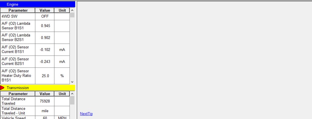

    Do you see this screen?

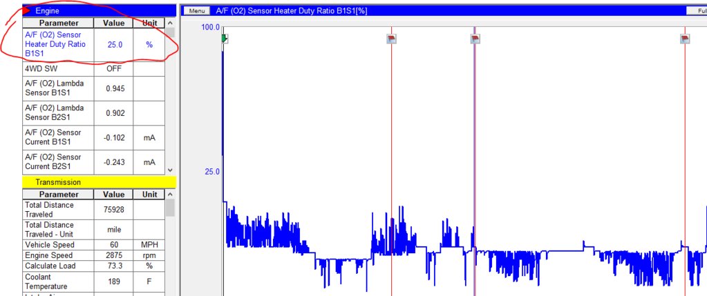

    Then double click on the PID should graph the PID and PID wil move to the top of the list in Left pan

    That worked, thank you!
