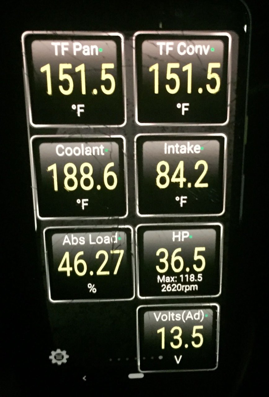

    I decided that I would like to investigate ways that I can lower my trans temps to add more safety buffer region during hard use. So, I thought of some ideas and set up an experiment to compare their efficacies.
    Test procedure: Drive a loop of road that consists of 4 miles at 45mph, 3.5 miles at 60mph, numbers recorded while passing by a land marker at the end of the combined 7.5 miles, then travel 5 more miles to return home. All attempts were made between midnight and one to avoid traffic and have more repeatability of the weather. Ambient temp was always between 70-75 F. No additional load other than just the vehicle.
    The measurements taken at the land marker usually didn’t change more than 0.1 F for a mile before or a mile after, so its convincing that everything fully reached temp. Heat soak of the engine didn’t seem to be a factor for the transmission. The first three runs were not from a cold start, and this can be seen in the different intake temperatures. I had driven the same road on days prior and noticed the same temperatures. I used one of those Amazon obd2 scanner to make measurements.
    *None of the numbers presented here are concerning temps, but the experiment is more controllable under low stress conditions. This is also cooler than what I see just driving around on the daily, so I’m not concerned about over-doing it.Table.jpg

    Once your transmission is fully heat soaked, it is much harder to cool down. The fastest way to get your trans temp down seems to be to drive above 45mph without stopping. Every time I pulled off to stop it went up 30 deg as I went through my residential area, and letting it sit takes hours to drop significantly in temp. I imagine that insulating the lines will help as I suspect that exhaust heating the trans is a large factor at low speeds. Switching to neutral builds more heat than just letting off the gas.
    In order of importance:
    1. Regular ATF maintenance
    2. Insulate the lines
    3. Ducting
