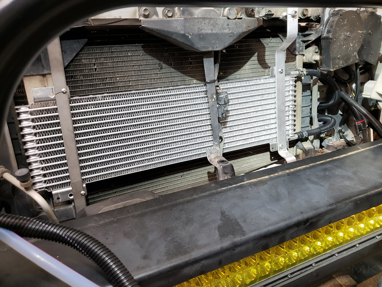

    Stumbled on this post from the front page. Great work OP!
    Even with this gigantic-ass cooler in front of my evaporator, and a fairly open grille, my trans temps are consistently in the 200s, and well over 220 on the hills. And this is not towing -- just keeping up with fast-lane traffic on CA desert freeways, while thoroughly overloaded with camping gear.
    Hoping the ECU-reported trans temps are erroneously high, but planning to do a transmission fluid service soon!

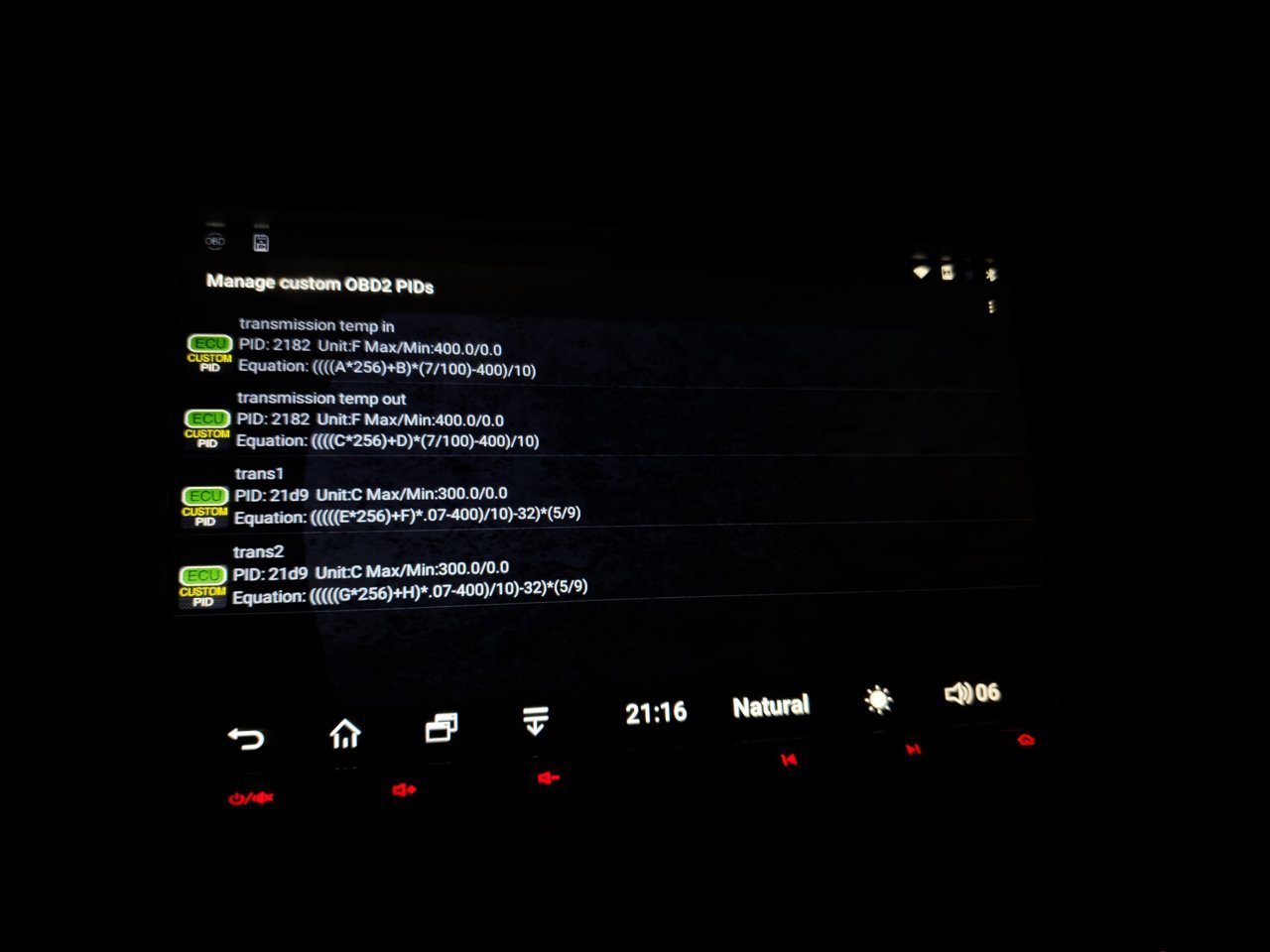

    Here's what I use on Torque. Not sure which ones work, but one if not both pairs of settings gives plausible readings on my '05.

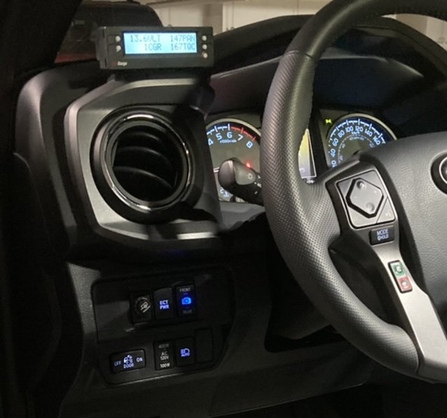

    Scangauge II, Ultragauge MX, or Bluetooth OBD2 reader with the torque pro app on your phone.
    Edit: you can’t read the temps out of the box, you need to program in a PID. It’s not difficult though. Took me ten minutes on the scangauge.
    This is in my tundra but same thing applies.

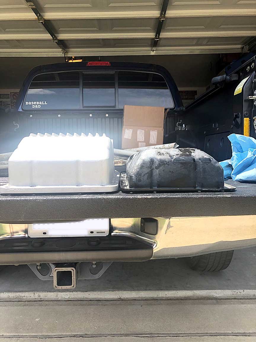

    138E01BD-247A-4FAE-B288-568C9F2B19D5.jpg 9E1FB324-25C8-42AD-B2F8-ED116C75F1BB.jpg Added this a few years ago. Got it for 150 as long as I gave my feed back. It added 3 extra qrts and is aluminum design. Haven’t checked fluid temps since the install.

    Is the idea behind it to keep temps down? From more fluid and AL acting as a heat sink? If you didn’t check before and after temps, what’s the point?

    The point is it’s cool. Not too many have one, lol. I generally do 30K services on it with the stock pan. Pushing this interval to 70K which will put me at 150K miles. As far as temps yeah I should check with this pan. The stock pan in traffic on a 95 degree day would see 195 with no load.

    PML is the manufacturer. Now I’m not sure with aftermarket market skids if they will work. Solid piece for sure. You don’t have to worry about dropping the pan to clean magnets. The drain plug has a magnet on it. Installed it at 80K, currently at 114K. I also use Amsoil SS blue cap atf as well. Shifts are smooth.
